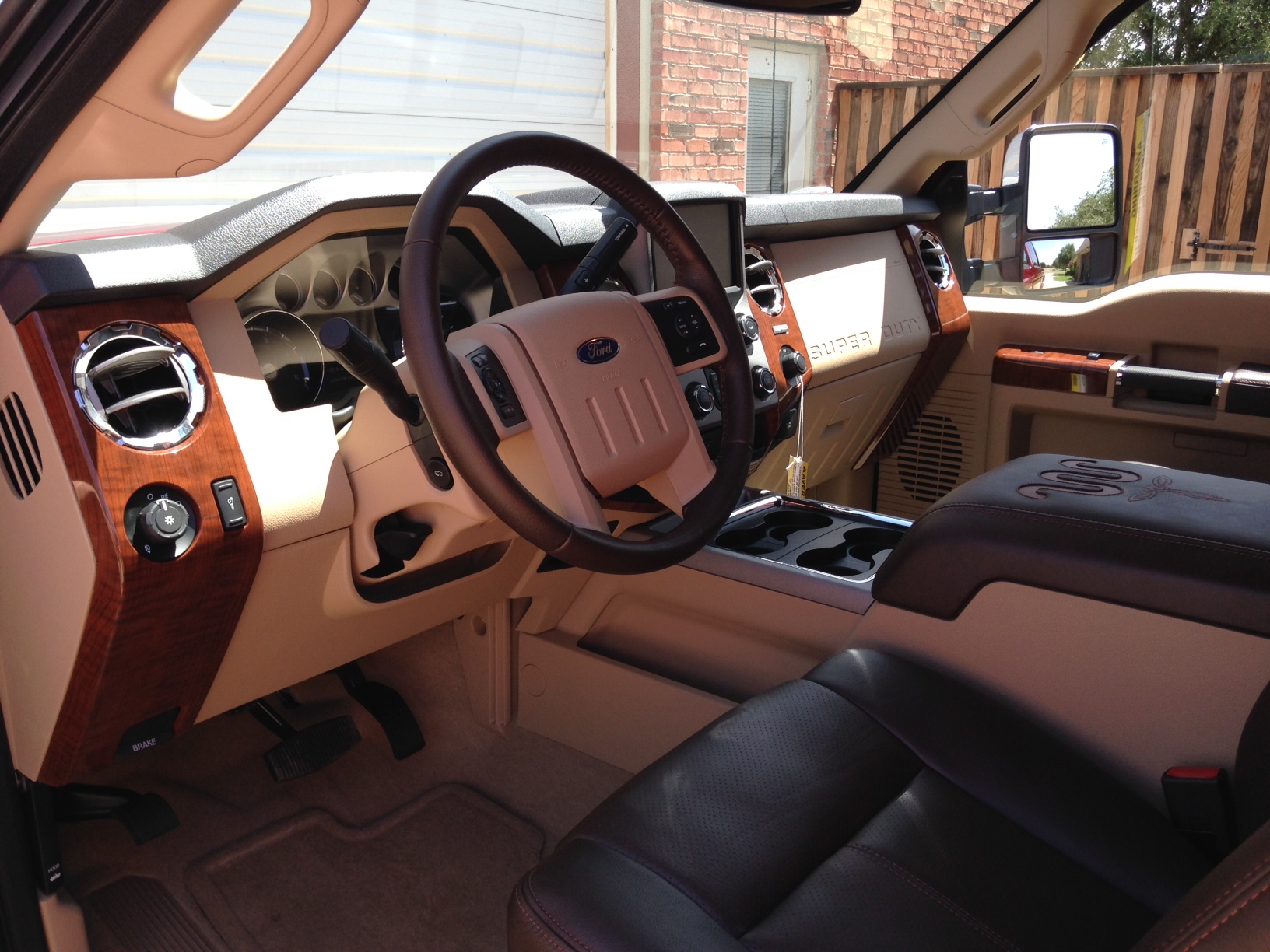

Can anyone tell me how the vertical panel to the left of the steering column comes off? It's the one that houses the vent and lighting control.

Remove the lower knee panel first, remove the two mount screws in the upper panel, remove with pulling force the vent panel. Seems as there is a small lip on the dash cluster panel that will hold the edge of the vent panel.
