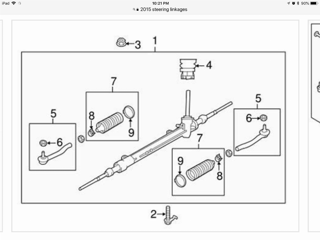

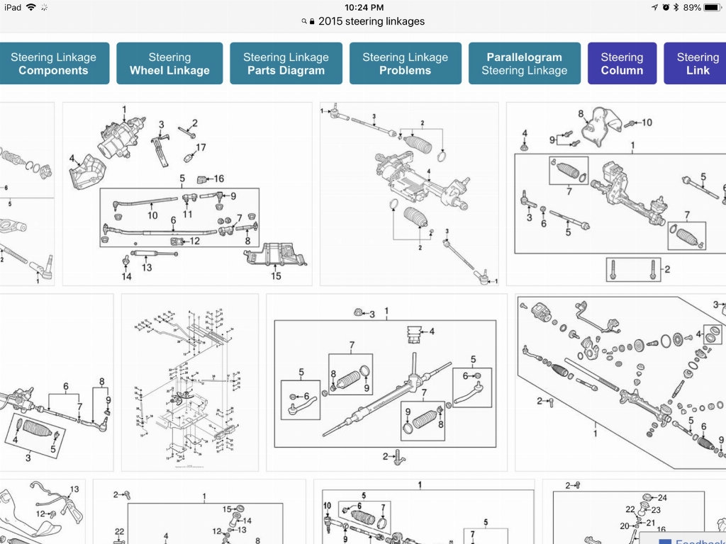

Ok mine is doing it now and one of my workers showed me what it is. I’m attaching a picture it is number four. Now this is just my truck but mine is the driver side that is broke. It’s that stem sticking straight up with bushings on both ends. You’re going to need another person to turn the steering wheel back-and-forth so you can look at all the linkages. When I got under there after you showed me it was very very clear what the problem is. I got the extended warranty from Ford because I know how expensive it is to fix a diesel so mine is all covered and I have an appointment in Odessa Texas next Tuesday.

What didn’t you understand. I provided a picture. I may not have called it what it is but the picture says it all. In the picture it’s the model in the middle and it’s that’s “stem” that is sticking straight up. Hell, now I’m going to go take a picture so you’ll understand.

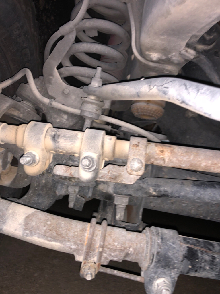

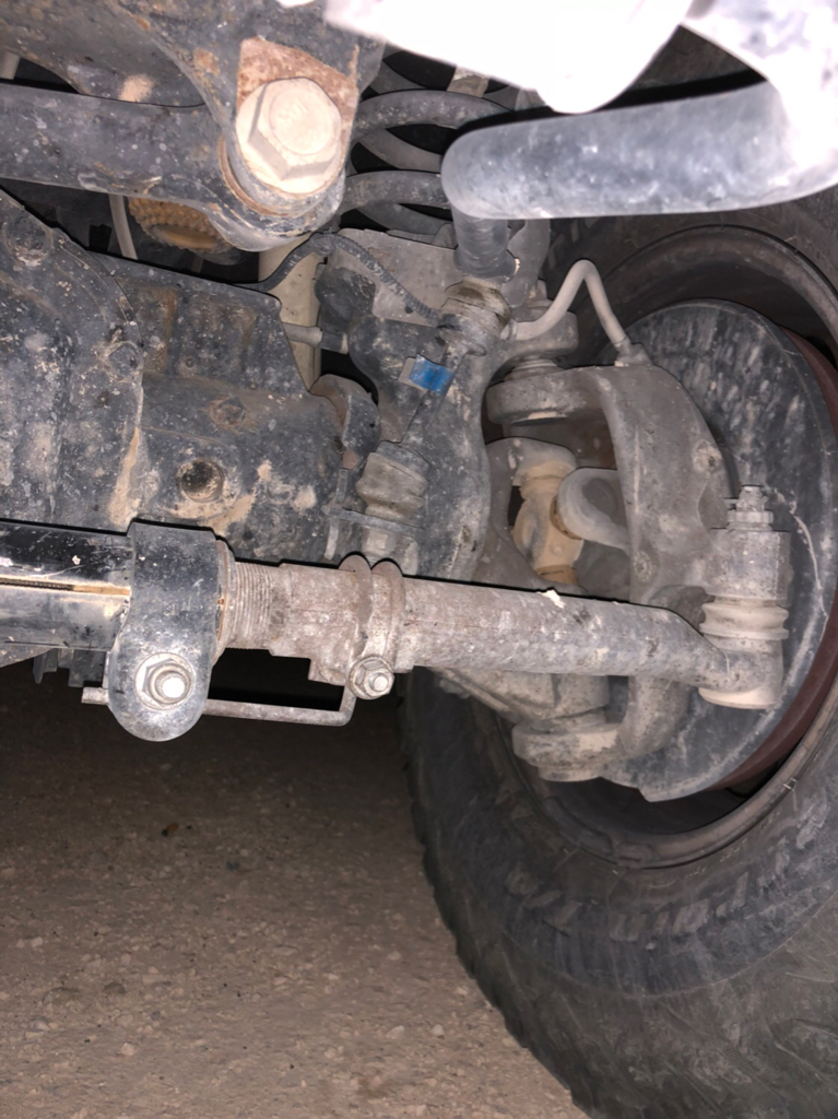

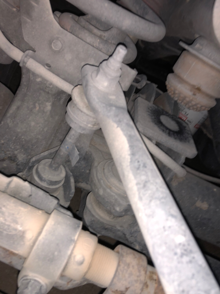

The first picture is the driver side on my truck which is broke the other two pictures are the passenger side of my truck of same part which is not broke. You see the passenger side is straight up and down where the driver side yes not.

Well first, the Google image you posted has absolutely no relevance to a ford, or your truck.
What you are showing in your pic is the sway bar end links. Sway bars help control body roll-nothing to do with death wobble.
