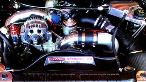

Nothing wrong with running a Delta line kit. It just rerouted coolant. Instead of coolant going into the intake manifold...it comes out of the oil cooler and can go to the degas tank or T into the coolant return line under the degas tank. I have mine returning into the PSP tank

This thread few months old and dead. You just wanted to show a picture of your engine. Btw looks really good.

Thanks, but no! I just wanted to show one way of running the Delta line. And to point out that there is absolutely nothing wrong with running one. And in fact...there are hundreds of guys running one without issues. Its the most recommended way of doing it with a ported intake manifold. If I really wanted to show off my engine bay I would've posted a full pic of it lol
