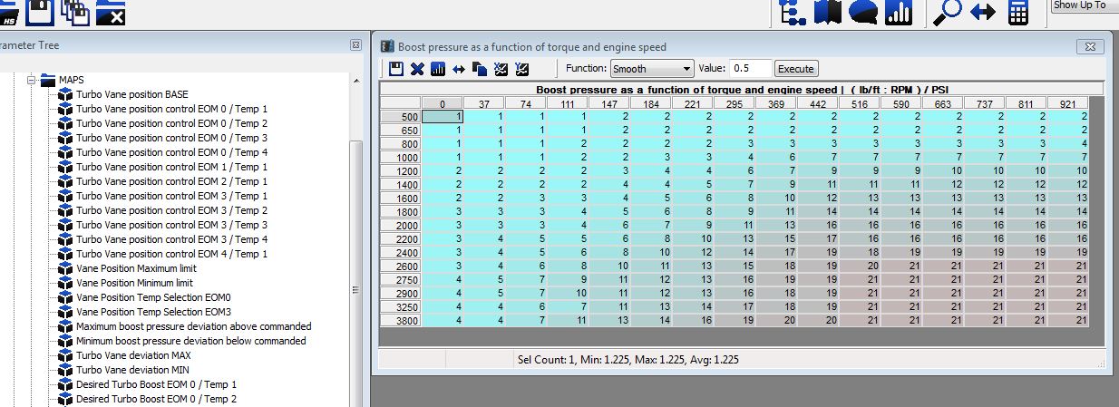

Does anyone know what the boost pressure as a function of torque and engine speed does? Do we ever need to change it? It doesn't look as though h&s has changed it.

from what I have seen that table helps the ecm determine the "torque" that is used in other tables. I have changed them some but not much Mostly matching the 2015 turbo tables to the 2012 ecm with the turbo swap.
