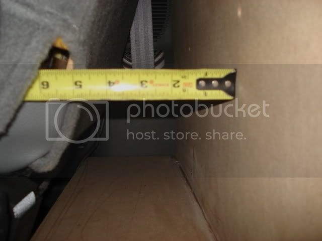

Would it be possible to put a jl 8w7 downfiring behind the rear seat in a crew cab? I have a Rockford p3s behind the rear seat but ready to change the system up. Any input?

and 8" MIGHT JUUUUUST FIT, but it is going to be tight, and thinking of the 8w7 I think the magnet is going to hit the seat even if you get the cone right down 1-2" from the floor.
Trying to remember back the years but I think there is a MAX of 8" between the seat and rear wall, all the way down at the floor, and it disappears quickly from there.
From here you could gain another 1.5" to the rear wall, but will need room for your box, even if fiberglass to cut down on thickness.
A less beefy 8" may work better, but they you would be able to forward fire it instead. I am pretty sure if you don't want to do a center console you would be better off doing a TW5 behind the seat.

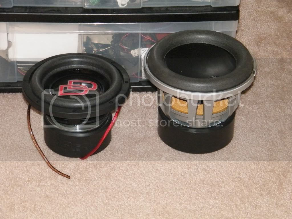

For the most part I agree with you on the JL brand, they are basically the BMW or Banks of the car audio world, pricey for what you get, but JL's stuff does flat out work. I doubt I would ever run JL gear unless I get it for cheap used, BUT the JL8W7 and TW5 are in a league of their own. The 8W7 is pretty much shares the crown for king of the 8s with the DD 1508. The W6 subs and slash series amps have won plenty of SQ comps. Most people look at JL's product list and figure the W7 is the king since it is their priciest sub, but they don't realize the W7 is JL's output sub, while the W6 is their sound quality sub and sadly the W6 gets overlooked more than it should.
The king of 8's for everyone, DD1508 on the left and 8w7 on the right.
