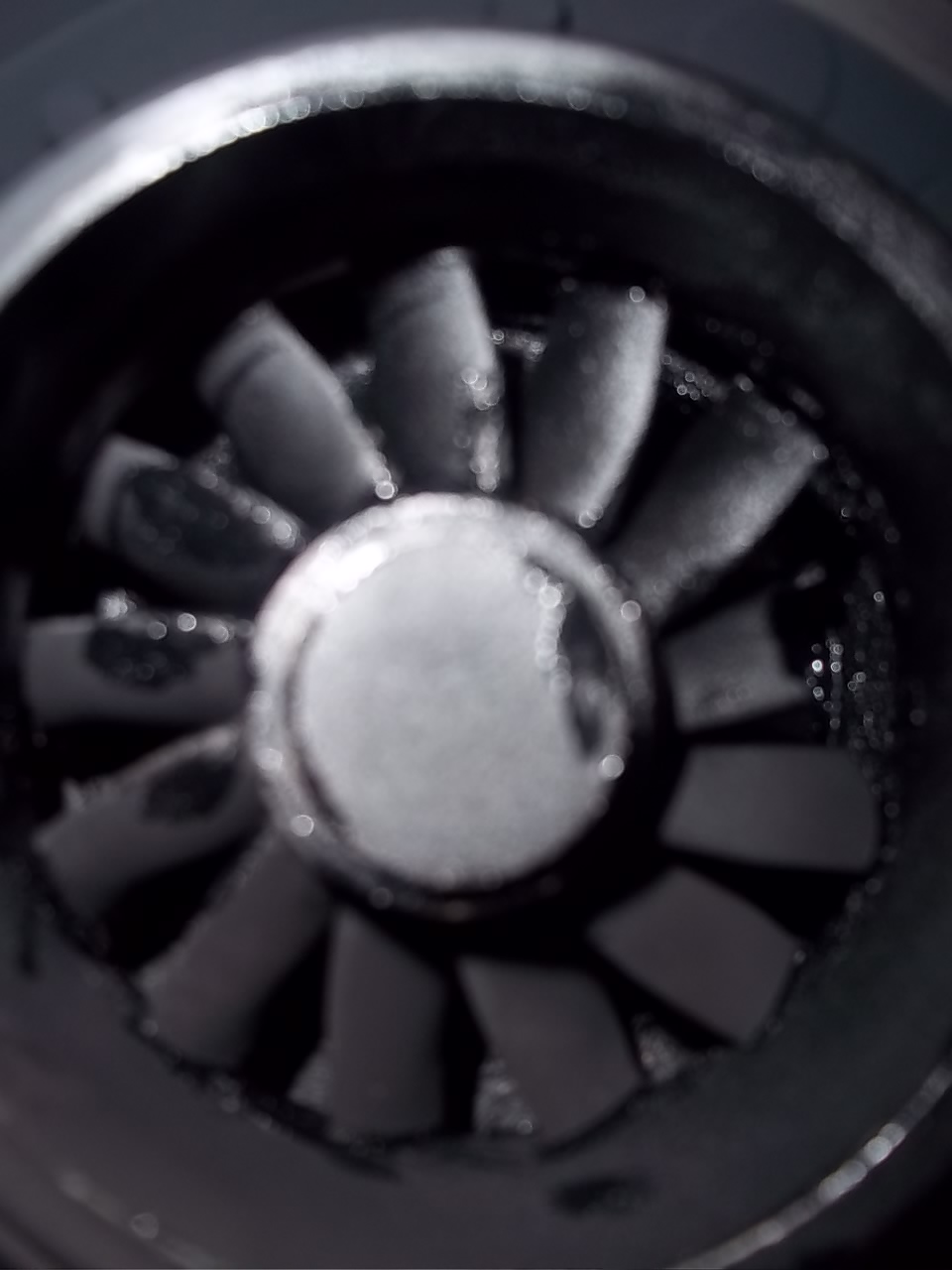

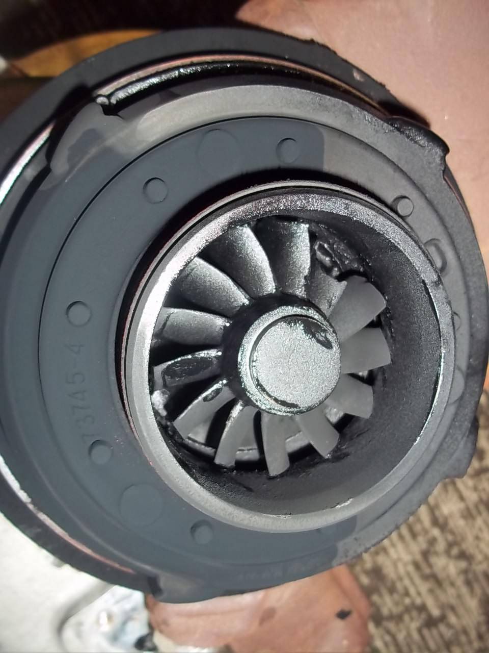

[QUOTE="mrplowjr_Ez_v, post: 951288, member: 4814"] I completely agree it should be checked more often and I will be doing that going forward. That said the filter had not been touched or checked since I had it in for a pretty good oil leak from the vac pump 3 oil changes ago. Its very obvious looking at the filter. I've been going with any dealer recommended service, its not like its severe duty, I drive it on the street that's it, the most work its done is tow a boat a total of 70 miles. I didn't see any damage to the filter, any holes, or signs of dirt in the intake tube with the exception of oil from the CCV. Besides, dirt ingestion might cause blade erosion and a low boost condition, but not bearing and shaft failure. Intake air should NEVER be in the center section of the turbo. There would need to be a massive amount of dirt for this kind of failure. [/QUOTE]
