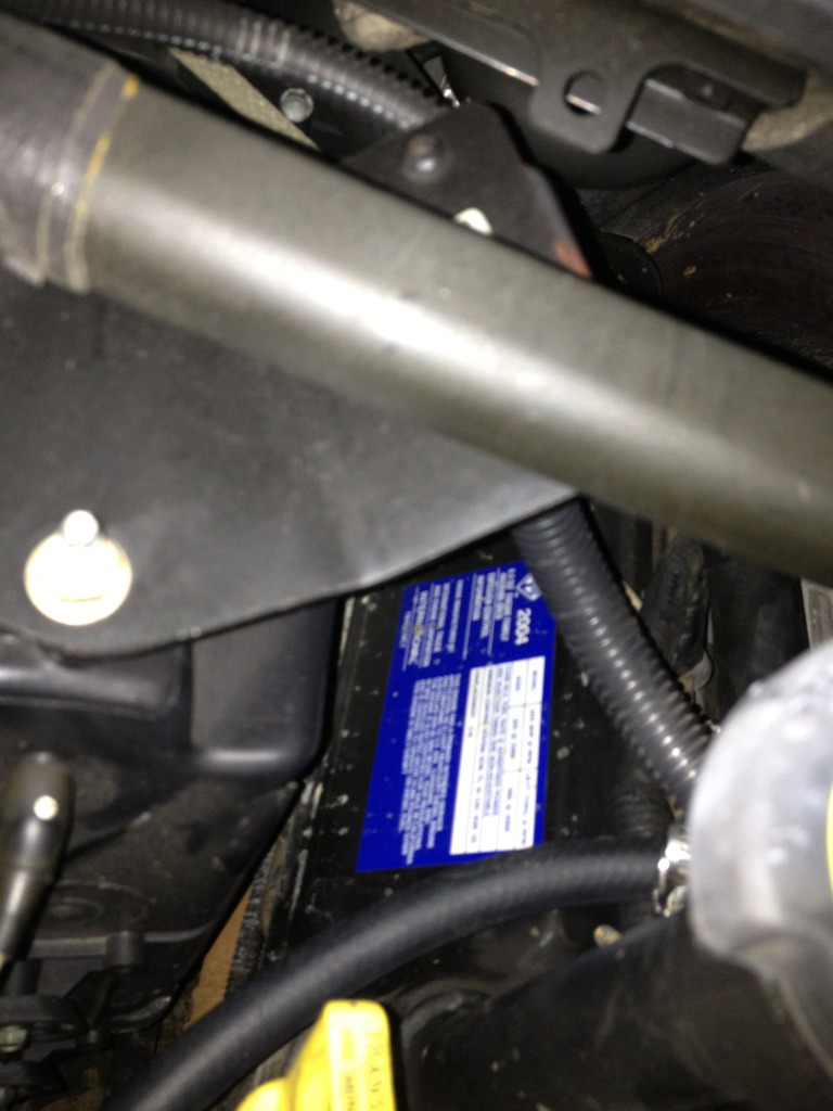

Early or late 04 6.0?
[QUOTE="HOOV3R, post: 708057, member: 4368"] Yes, that is a late 04. It has an 03 style pump and 05 rails. Intake doesn't use the crossover in the rear, but it still has the butterfly valve in the intake elbow. [/QUOTE]
