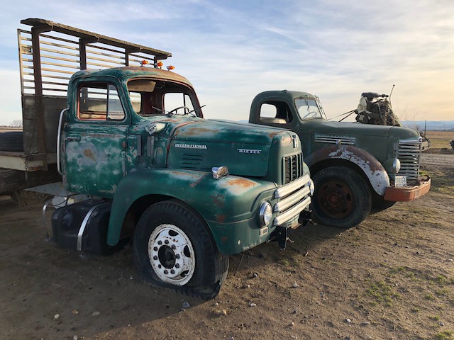

So what does "coarse gearing" mean? Its on the spec sheet and thats what the '5' in the model number stands for.
Also heres some pictures

Restoring the truck it is sitting in now would be an even cooler project! :toast:
I think that's what he is kind of doing, just with the dt transplant and a better transmission in the kb11. I think it'll make for a sweet ride and I'd definitely go for the dt transplant with that body.

Ha Yea! the Army Green truck with the white on the fenders is the truck this is all going into. The glittery green flatbed truck (International RDF-190) has the dt466 and Im getting the transmission out of like a 80s something peterbilt.
The RDF-190 had the DT466 swapped into it after it blew its original Cummins and was done by someone else. The barn it was being stored in fell onto it 2 years ago, before I got it.
