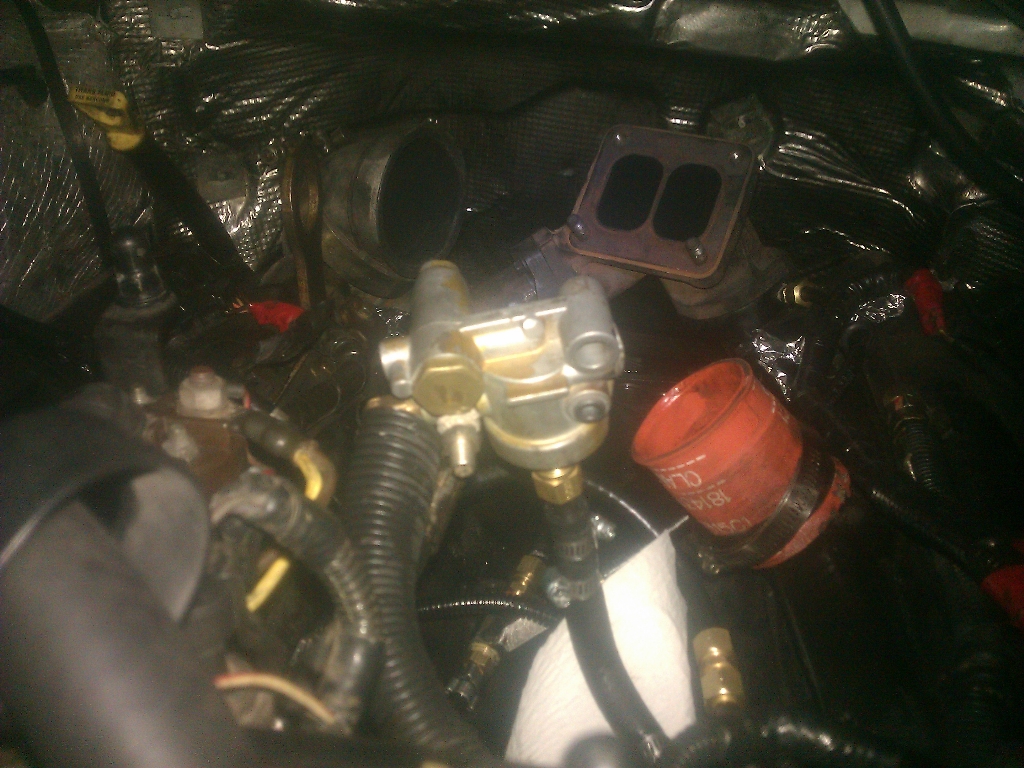

yup. I built my own for less than 500. I cut parts of the stock regulator and made it work... so far it has been on my truck for 2 years and over 25k
Think you could snap and post a pic on your valley showing that part?

UTAH
Sent from my iPhone using Tapatalk 2

Sweat! Makes me feel better about what I what to do now. I'm on benefits, so it takes me a while to scrimp for things.
So you have the original 2 from the front side... and one from underneath/further back to back the return to the tanks?

Yea I still have the return line and selector valve in use... However I am planning on a 38 gal rear sump and a1000 pump to feed the new injectors I have coming
