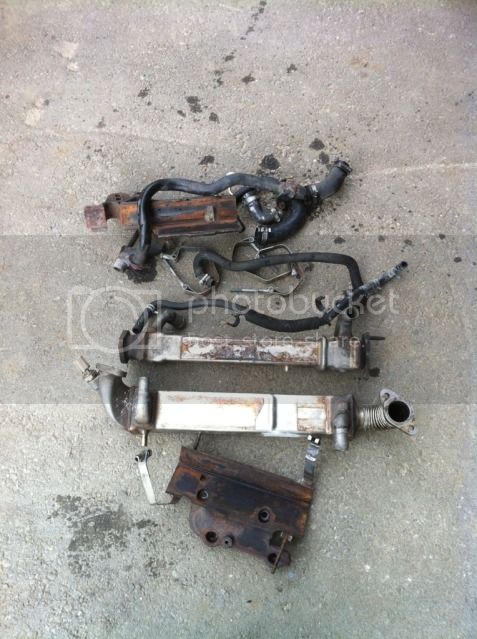

This is all the crap you get rid of without doing the elbow, EGR valve, and the intake butterfly valve (whatever it's called.)
