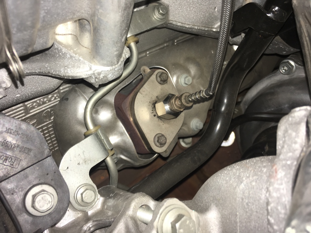

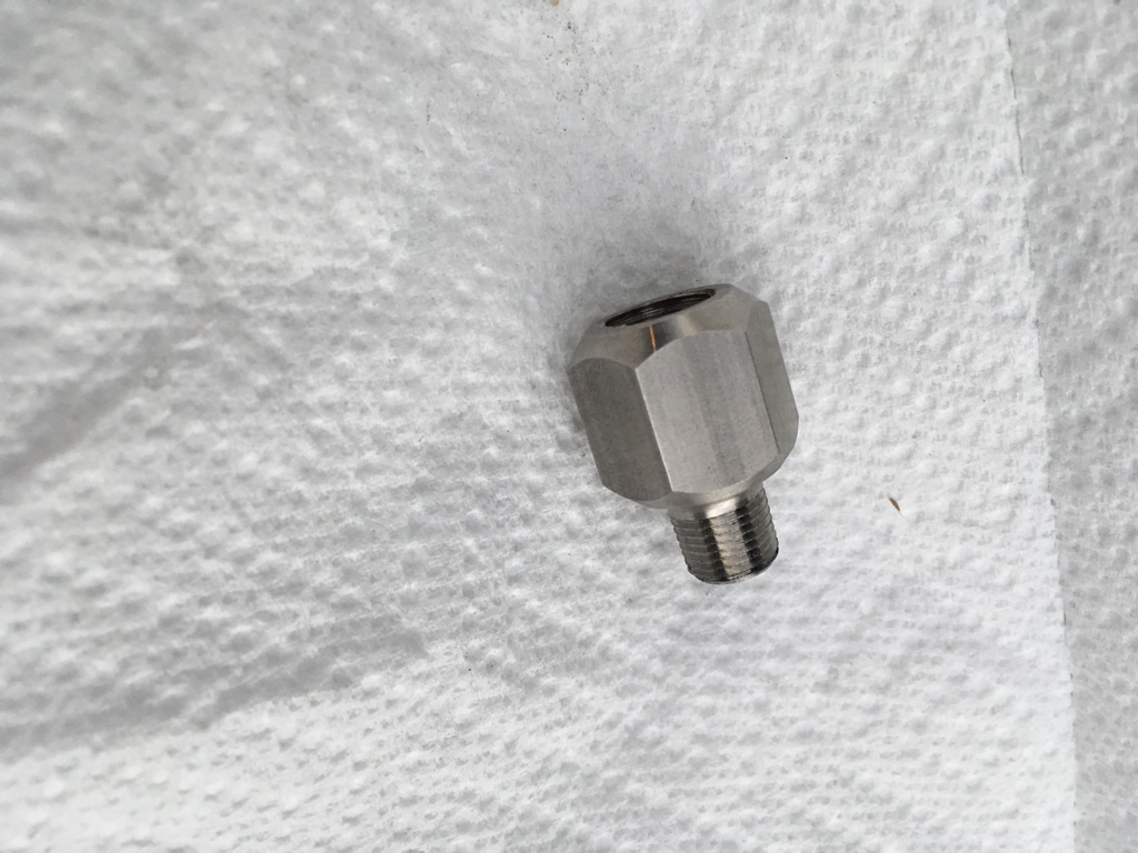

So I just got my EZ Lynk installed and pulled the SCT sensor out since I no longer need that. I pulled an EGT sensor from my deepeff and went to install it into the block off plate and it wouldn't fit. I immediately thought I had the wrong size plate because I had those plates sized for the 1/8" due to the SCT sensor I've been using.
So luckily I was able to find the adapter and get the sensor in, but now I'm having trouble figuring out which one to plug it into?!
Please see the pictures below so you see what I'm talking about. I'm at a loss.
Thanks!
Here's the adapter I was talking about to make the sensor fit.
Sensor all installed and tightened.

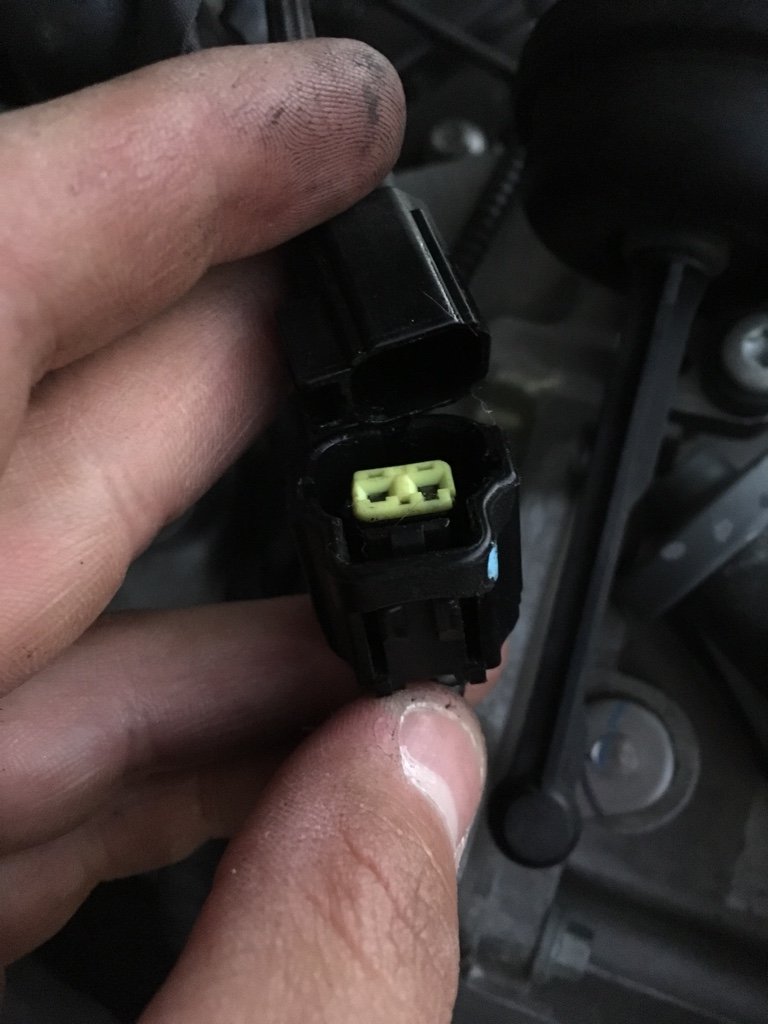

Notice the position of the prongs inside and the locking tabs on the outside.

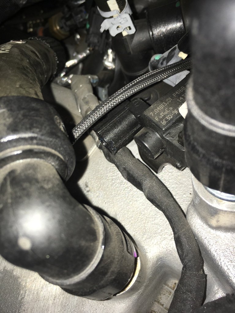

This is the only sensor I can see it plugging into as the Orange one next to it is for the EGR.
I noticed this was unplugged is this what it could plug into?!

When u pulled the exhaust pipes off for the blocker plates. U unplugged a sensor. That connector goes to ur egt sensor u have in now to read egts. It is right under the intake up front close to the fan.

Sure looks like it.
ImAti0n
May 8, 2016
225
Oh so the sensor up front? I'll take a look right now.
ImAti0n
May 8, 2016
225
That was the one! Thank you! All hooked up and running properly now
