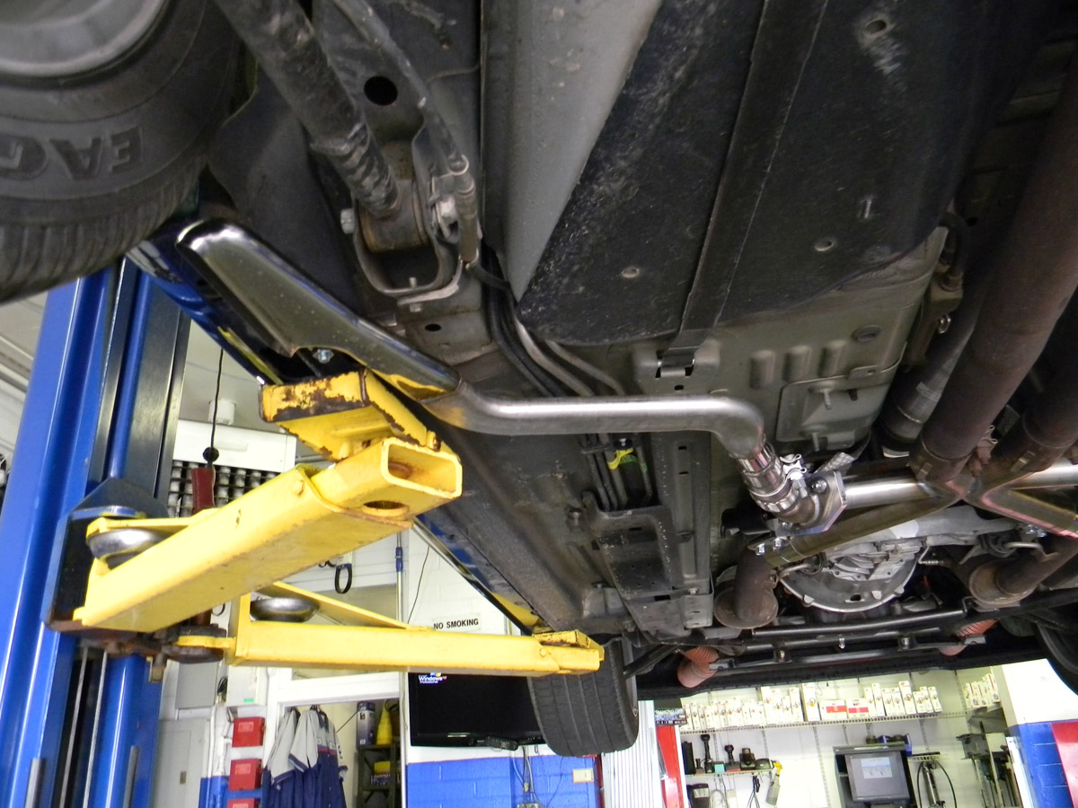

I had an 88 mustang with cutouts, had pipes run from the cutout to just in front of the rear wheel. Wish I still had the pics, but here is one very similar.
but like dsberman94 said, you'll get flow out of both pipes, but most will take the path of least resistance and dump.

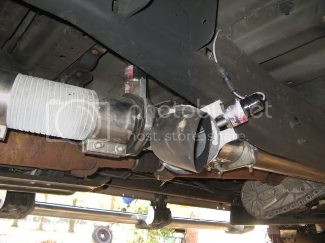

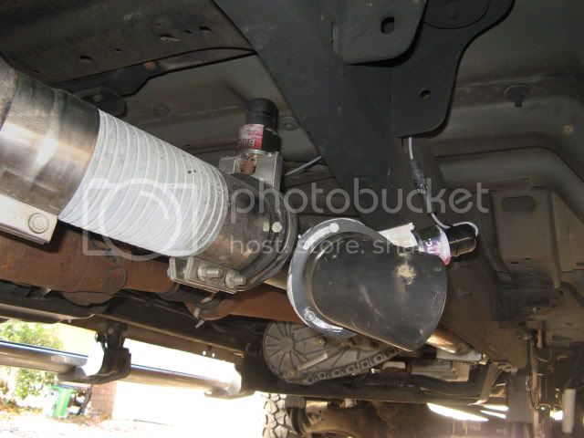

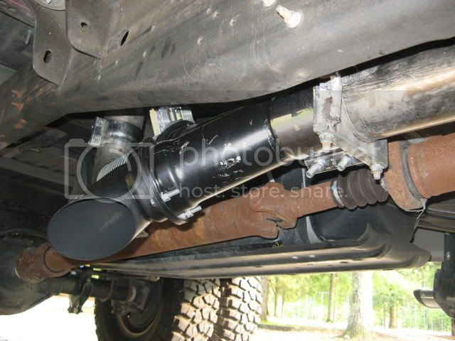

I did this a few years ago. The stacks were too loud for my wife when I would haul trailers. I put 2 valves in. This way when I shut one off the other was open so I could direct the flow where I wanted. It is dumped under the passenger rear door. Its actually pretty quiet in the cab with the stacks off.
