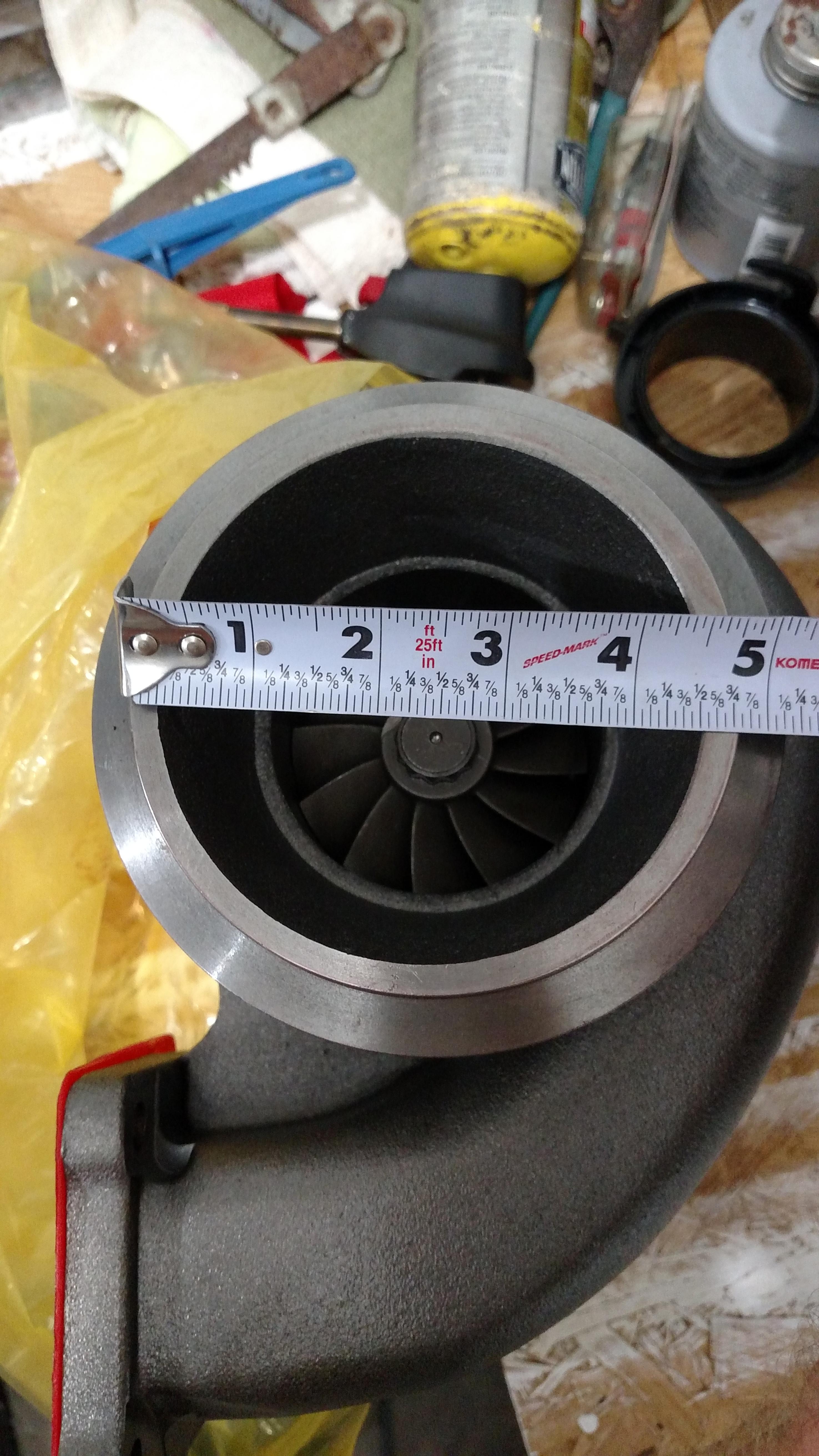

Putting a HX50 on the old 7.3 and am having a hell of a time finding a flange for the exhaust side so i can start my fab on the down pipe. Here is a picture of the ID and a rough of the OD and of course it's tapered. Any help is appreciated

I went to NAPA and got a flange from them. Then it's cut, tack, check, cut again, tack again, over and over. Use a marker to mark where you want to weld it together.
