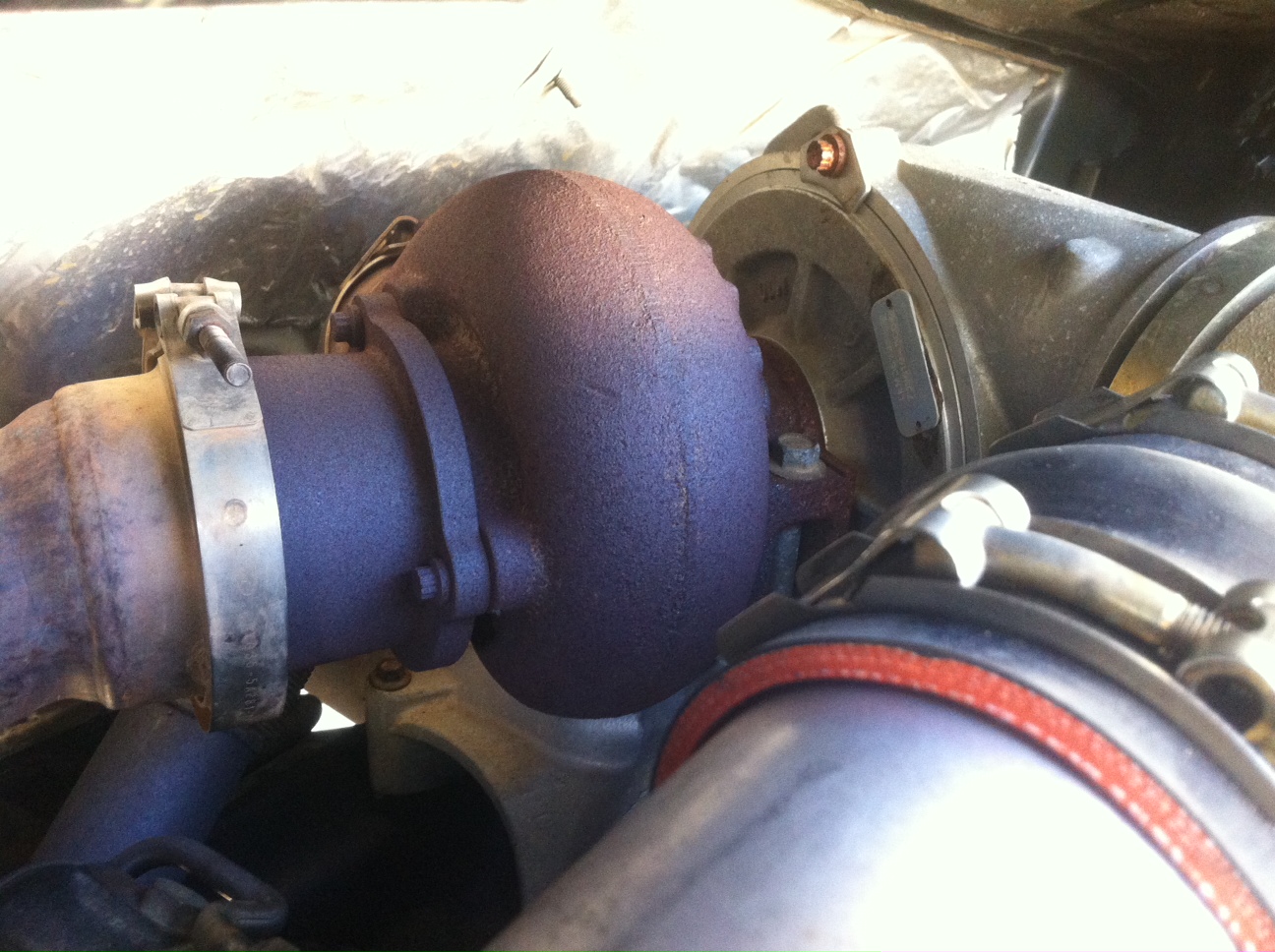

See if you can snap a pic of the 1.15 housing and post it up so we can see it
As requested. Maybe this will help with my redemption. Lol The first picture is the 1.15 housing, the second and third are the stock Super Duty .84 housing just from different angles. I know the .84 and 1.0 adapters are the same because I put my 1.0 turbine housing that came on my 38r on a buddies stock turbo and reused his outlet.
I actually have the stock downpipe on my 1.15 housing, so I see no reason why a 4" downpipe wouldn't work either.
No worries. Anyway, what was your reason for changing the 1.0 housing in favor for the 1.15?
Back when I did mine CSIPSD and others were saying the GT38R still exhibited compressor surge with the 1.0 A/R housing that it came with and didn't with the 1.15 housing. I was currently running with my wastegate on my stocker disconnected otherwise I couldn't get over about 20psi and my truck ran cooler EGTs and faster spoolup and higher psi. At the time not knowing too much about it, I went with it. The only regret I have is not keeping the 1.0 A/R housing to try it out, especially with some new dyno evidence to suggest that there may be more power to be had with the 1.0 housing (at least with a compressor wheel change anyway) and quicker spoolup. That being said, I never hear any surge, my EGT's are great, spool up time is fine and my exhaust back pressure seems to be reasonable, so I probably won't be trying out a 1.0 housing anytime soon.

The van adapter looks like the high flow outlet from beans, but the vband flange is smaller where it bolts to the downpipe. So a van adapter will not connect to a superduty downpipe.
