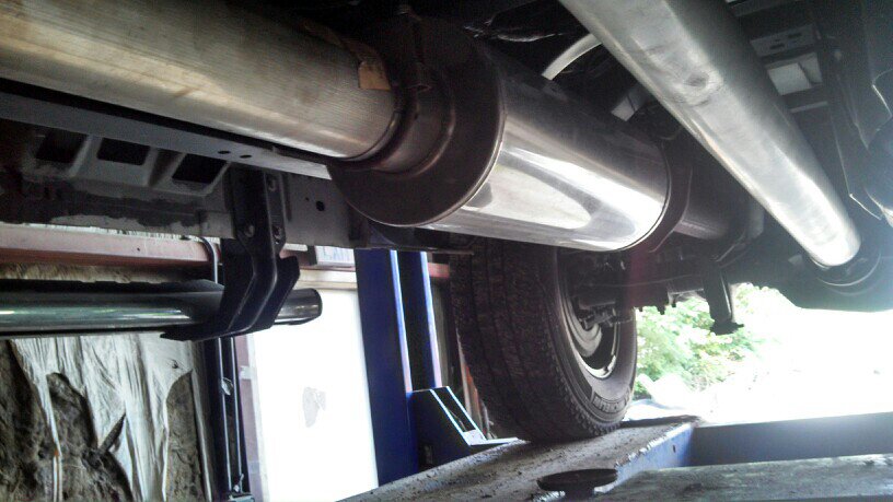

I got the flo-pro polished muffler and chopped the delete pipe for a couple customers.
Was very quiet and inexpensive

So is this just a delete pipe that was cut for the muffler but uses the OEM over axle and tip? Did the muffler need welded on or just clamped?

yes it was just a delete pipe that I cut a section out of and placed the muffler in it. this was mocked up with regular clamps then I spot welded on each side then finished up with stainless shrink clamps. doing it this way you can use any cat back over the axle kit or the factory tip to make it inconspicuous to appear stock and sound stock. we all know that we don't need any more epa attention than we get now, so this is the way I have been doing it. (new truck and being loud throws a big red flag)
