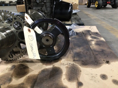

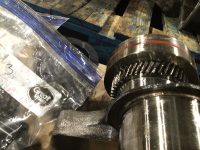

Joe (salesman) tells me that my engine is completely torn apart and that they are trying to figure out what happened. He sends me a few pictures of the damages, a facetime call with the service manager viewing the engine pieces. And things are just not lining up with what Cass (owner of Choates) is telling. Cass is trying to convince me that a bolt was dropped into the timing cavity during installation. Sat there for 40,000 miles before working loose and finding its way into the timing gears. So i ask, did you find the bolt or pieces of a bolt in the oil pan? He tells e that all they found were tiny metal shavings an they could identify where they cam from. but he knows this is what happened, but cannot prove it.
I do want to note that there are no nicks or marks on the block or the timing cover at all, they look as they were made. So i cannot believe something went through the timing gears and evaporated into dust without leaving a mark no any other parts. The only damage was to the cam gear and the crank timing gear (attached pictures). And since Cass "believes" or "knows", they are refusing to cover it under warranty. And are trying to hit me for +$11k in repair costs. I have spoke with several engine builders and they all say the same thing that if they cannot prove their theory, they should cover it under the warranty. One guy even said that just because someone believes it to be true, doesn't make it so in a court room.

My theory: the camshaft was bent and the gear lash went tight in that one area. Causing the gear teeth to eat themselves. this would explain the fine metal shavings and the very odd missing teeth.
