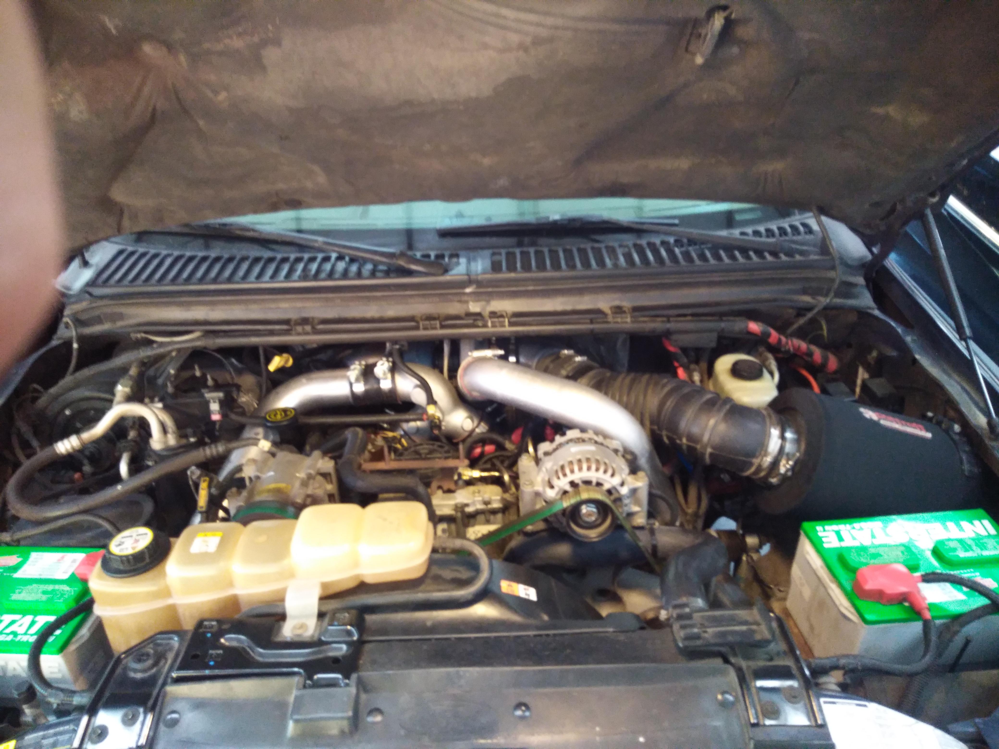

I changed out my cps, icp, and ipr today. There was oil in my cup connector. Cleaned up everything really good before putting In new sensors. Now my truck seams to run a lot better and a lot smoother.
