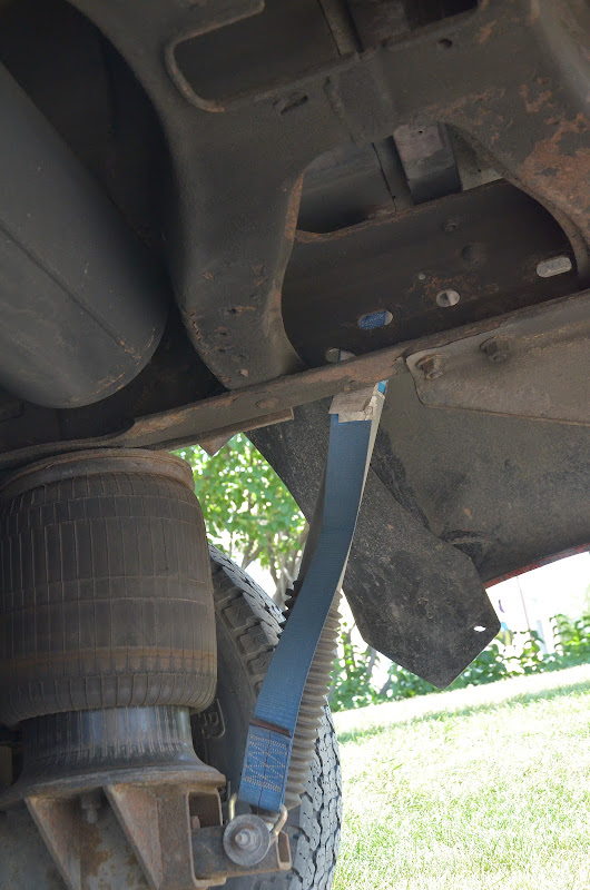

Can you send me a picture on how you mounted your limit straps?
me2
Nov 14, 2011
548
I used some inexpensive tire hold down straps. The eyes are a triangle, not a bolt hole like the real suspension straps.
I just bolted them in with a big washer, to try them. They worked well, so I left them that way. No issues.
The air bag is a bit over inflated in this picture. The strap usually has more free length than what is shown here.
