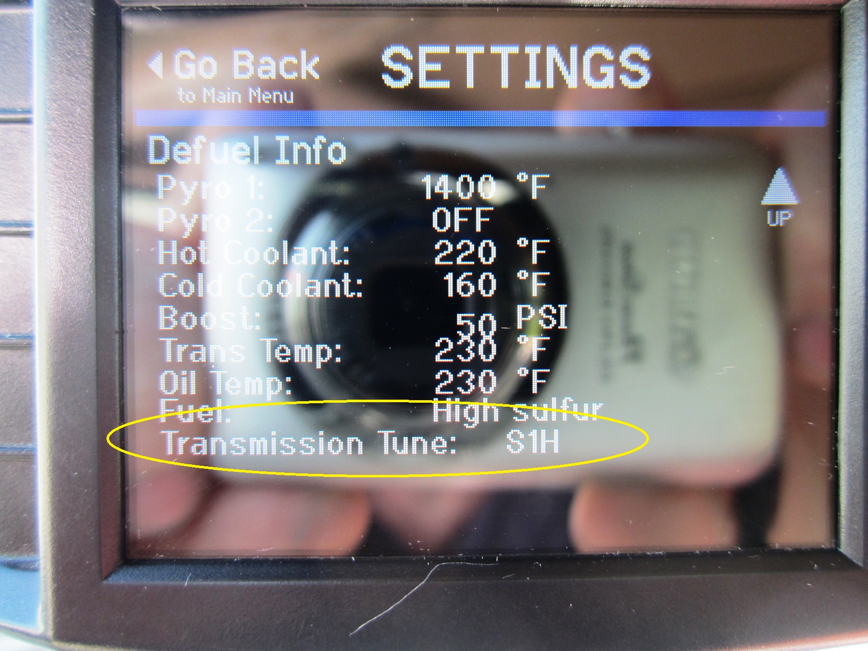

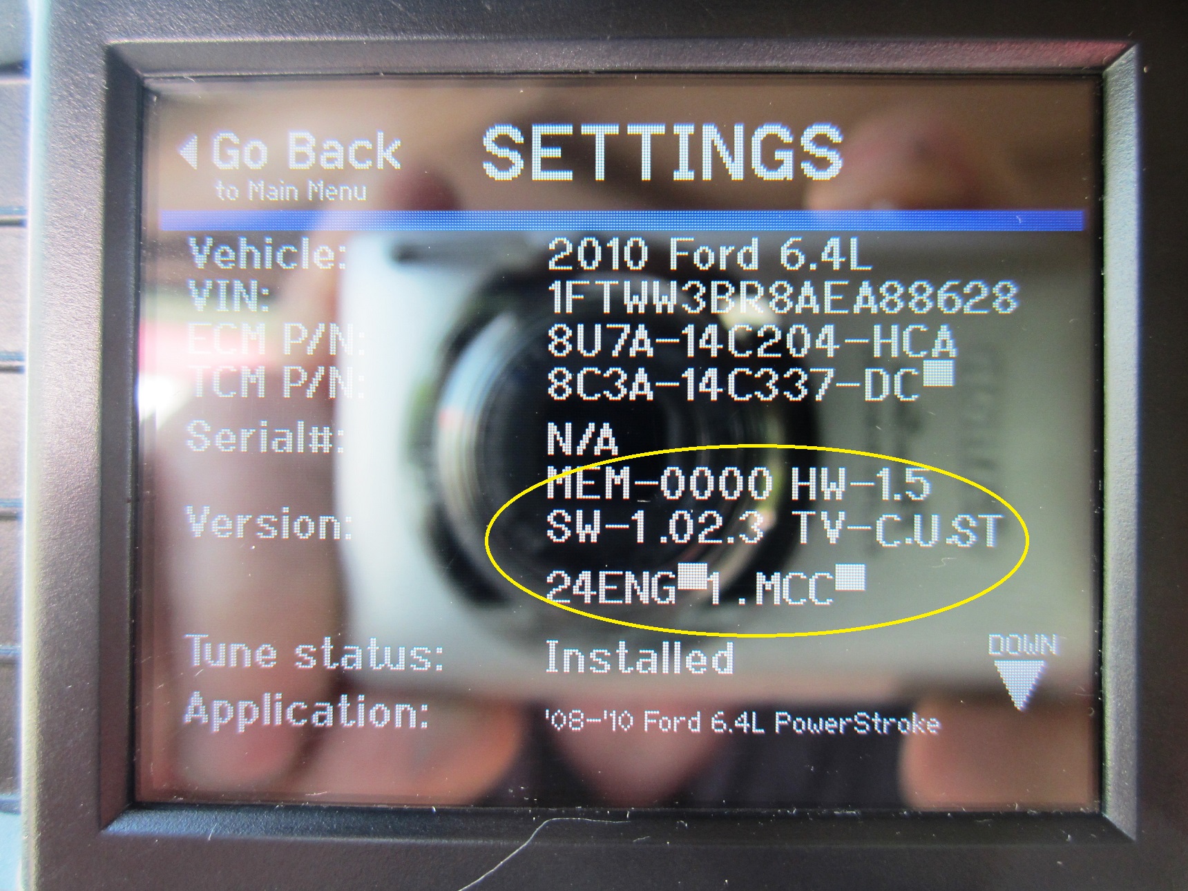

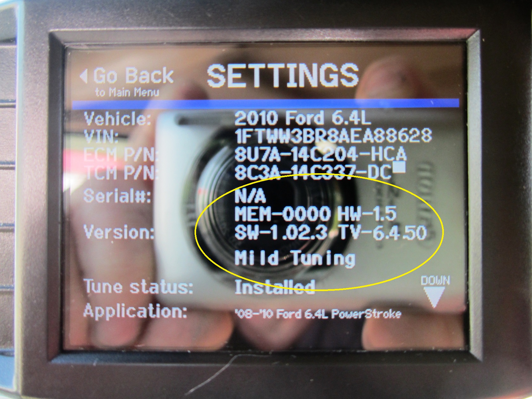

If your have a single turbo set up with an H&S tuner, you are most likely running a custom tune thru their MCC. Someone their in Alberta should be able to write you a transmission tune to get your shift points & converter lock ups where you want them.
Take a look in settings and see what is loaded
