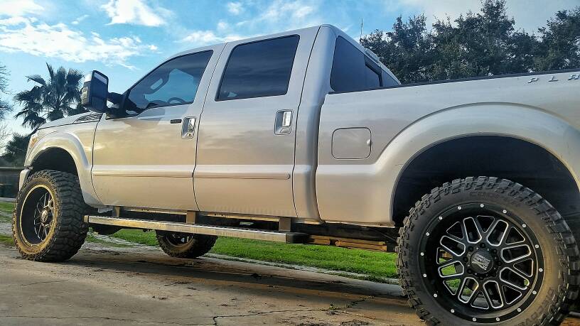

I'm really just look for something that is going to stick out 2-3 inches past the fenders not sure what the best route is to go.

That's because some people say it works but are willing to live with rubbing in certain situations. Some of us are not willing to do that. The wheels and lift you pick will be dictated by which type of person you are.
Rubbin is racing Harry :toast:
To the OP, go with some 10 wides, they stick out some. I have never put a tape measure on it, but I'd guess they stick out a couple inches.
