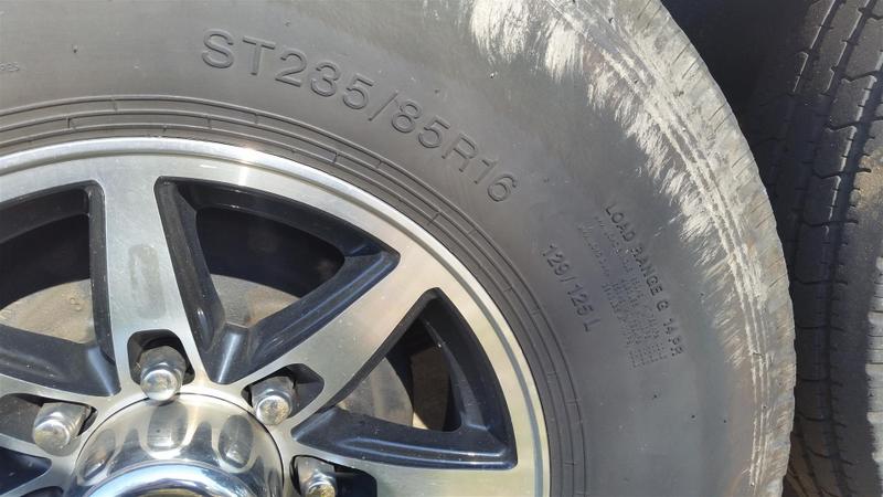

Also note that ST tires are rated at 65MPH max I believe. I take them off
and replace them with Michelin Ribs are the Bridgestone equivalent. They
last forever and can take the speed and weight. Just keep the at max inflation so
they slide easier when turning the trailer sharp.
Check the LT tire weight rating if you use them to make sure they have enough for
the trailer.
I was blowing out ST tires like popcorn until I found out the speed rating is below
the speed I tow. Once I went to the Ribs I have had no issues at all.

hubcaps
G rated and nitrogen filled
I guess I have a different perception of hubcaps. I thought they covered the entire wheel. Either way see the part of the rim that the lugnuts are at. Shoot that with a temp gun while traveling and that will tell you if the bearings are going out.
I am not a fan of nitrogen in tires. To much adding and removing of pressure for me. I know nitrogen doesnt expand as much as air but still does.
Even if they are G Rated, if they are ST tires, remove them. You will thank yourself later, as stated above by others they suck.
LT tires are rated the same as the ST tires I had so I am good but you are correct they can be less.

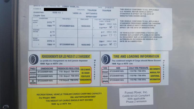

According to this chart they are 7000lb axles.
I seem to remember the mfg rep telling me they are upsized from even that.
Anyway, let's say they are 7k axles, that's 3500lbs/tire and none of the LT tires are in that range.
BTW, I have CAT slips w/ 13,800lbs on the trailer, 10,600 on the truck (Front: 5020, Rear 5600). And I had room to squeeze in 1 more motorcycle.
