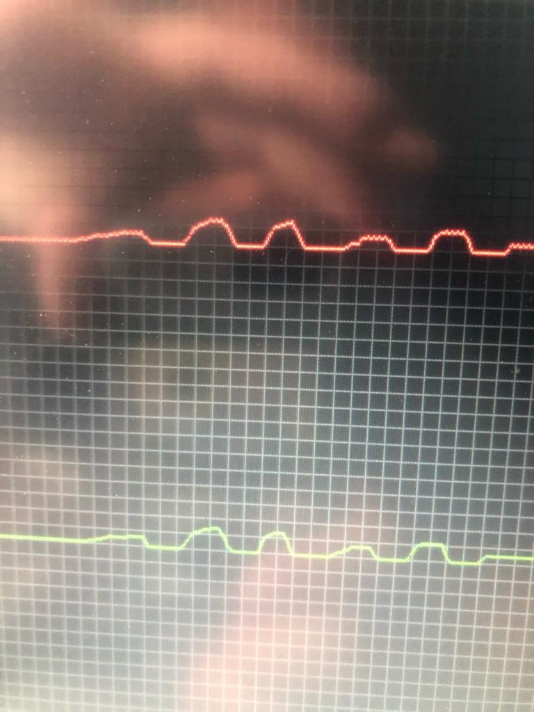

Forscan Pedal position ?
Jonnydime
Jun 26, 2012
2,324
8
Do these look right. D & E look ok but while driving they do differentiate somewhat. The top one concerns me the most as its all jagged all the time except for zero pedal. Also the scales look funny to me since they are all not the same. Can someone duplicate this for me for comparison or do the 6.7s have the same pedal and I could compare from one of those.
sootie
Oct 3, 2012
11,853
40
Set the cruise on flat ground and check again. It should flatten out
Jonnydime
Jun 26, 2012
2,324
8
what do you think about the scales on the side. The first pic is me flat footing it and the top graph only goes to 78% while the other 2 go to 99%
Sixfoh
Nov 12, 2019
94
My D and E vary by 5% often and this number fluctuates. Wondering if its a possible issue as well. No to hijack your thread
