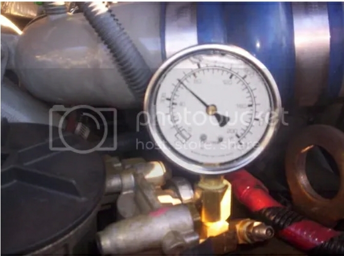

Anyway, I just did the bb fuel pressure regulator shim mod where you put a bb in between the plunger and spring that's located under the 19mm bolt on the driver side of the fuel bowl/fpr housing. Underneath that 19mm bolt there is a schrader valve for testing your fuel pressure. I saw a mod awhile back about removing the schrader valve and using several 1/8 npt fittings to branch off of the area the schrader valve screws into, in order to add in a liquid filled fuel pressure gauge, and then a 90 elbow at the end where you re-attach the schrader valve so you can still hook up a removeable gauge. So basically what you have when you're done is a line comming off of the fpr with 2 branches, one branch goes to the pressure gauge, the other goes to the schrader valve. I did this several months back and put everything together dry, and when I tested it I was leaking fuel from the new brass fittings. Then I used regular plumbers tape and the diesel tore right through that, causing it to still leak. I did some researching online and found that rector #5 was able to be used in diesel applications. So I got some of that and finally got around to trying again today. I thoroughly coated all the threads with it, not too much, not too little. Then I attached everything to the fpr and let it sit for about 30 mins before cranking the engine to test for leaks. When I did, it was immediately clear that every fitting was leaking.
My question is, how much should I tighten these fittings down? I don't want to damage them or warp the threads, so I've been getting them "snug" but not super tight. Is that the reason it's still leaking? Is it just not tight enough? I can't think of anything else. When I remove the whole assembly and just reattach the schrader valve directly to the fpr housing it seals just fine. Even when dry! But it seems no matter what I do these brass fittings continue to leak.
