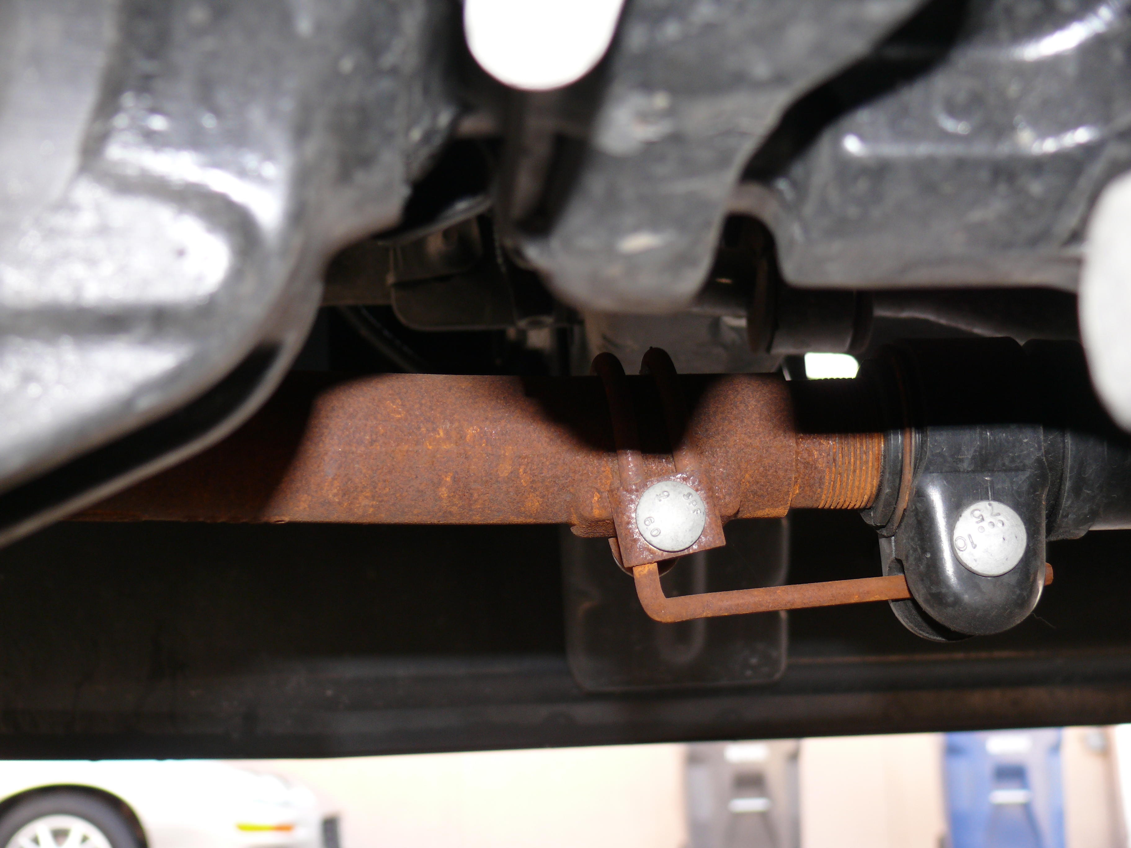

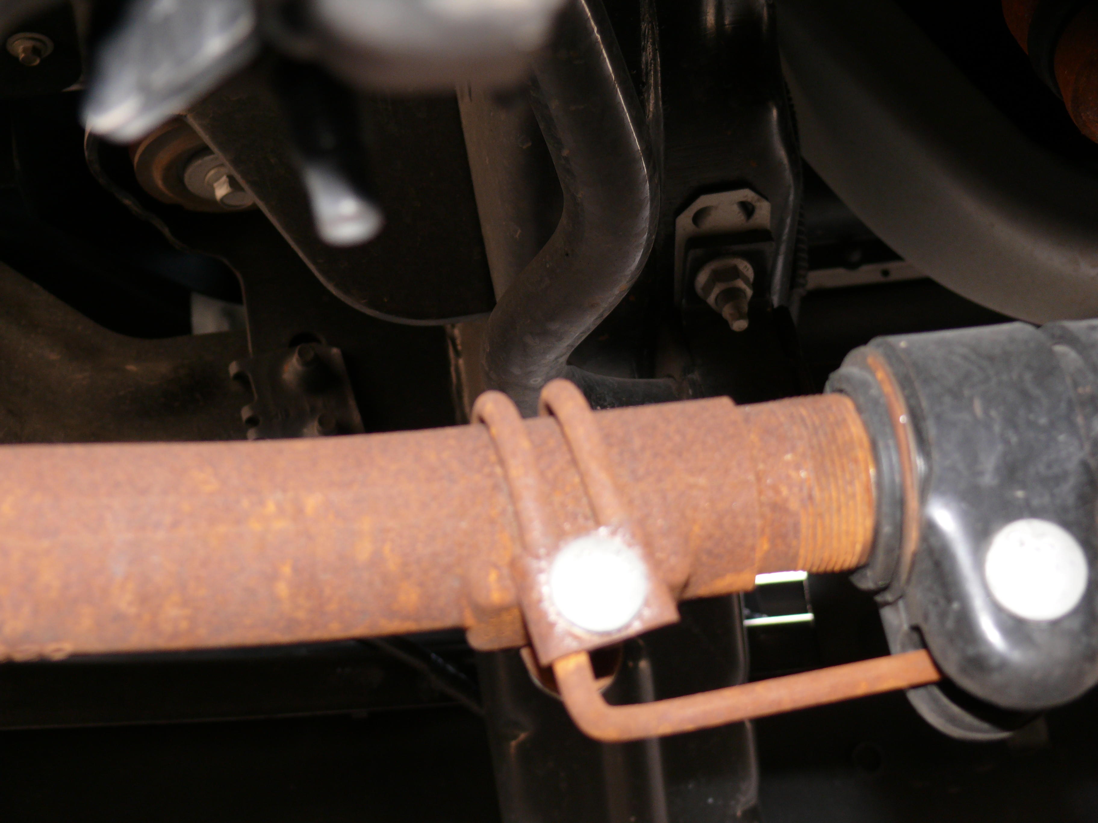

Bought this new last summer and parked with the wheels hard over to one side I noticed that many of the front end parts look extremely rusty. Never had this in the snow and it doesn't rain much higher here. Certain parts look fine but others are orange!
If this is normal for the 250 I gotta say it looks like hell.

I'd say it's normal from what i've saw. Some parts are not painted and are raw from the factory. So they will get surface rust.

The ones still at the dealer are like that. Knock that rust off with a wire brush and a pressure washer if you have one. Then shoot it with some self etching primer and semigloss black. I do it to my 2004 ever year or so. Keeps anything from rusting really bad and looks a lot better.

Name one vehicle on the road today that doesn't have parts underneath it that have surface rust on them.

Big deal. Mine look the same. My dodge looked the same. My Infiniti looked the same. Moms dmax looks the same. My roommates dmax looks the same. My wife's xterra looks the same. Dads corvette looks the same. If there is steel exposed to air that isn't protected it's going to get surface rust. If its THAT big of an issue then wire wheel it and paint it real quick.

It isn't THAT big of an issue for me, but yes, I'm a little disappointed that these parts aren't treated or coated with something. I've never seen a vehicle come from the factory already rusty and I've probably bought 8 or 10 new cars and trucks in my lifetime. This one being the most expensive and nicest I've ever owned. I just wanted to get a sanity check and make sure this one wasn't sitting in water someplace for a week before it got delivered.
