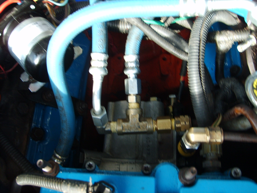

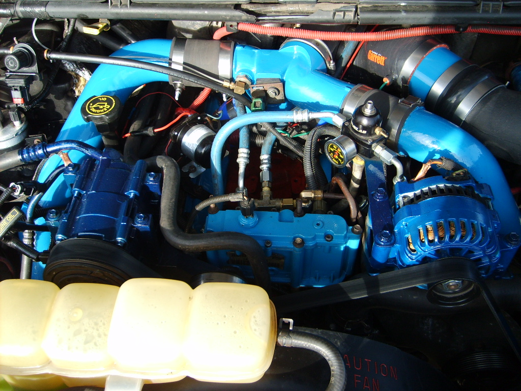

Does anyone have a fuel bowl delete by Diesel Innovations and do they have a pic of it? I wanna see how clean it looks on the engine. If not I might go with strictlys kit

no gains to delete other then no orings to fail,cleaner look,room for twin HPOP's,use of $8 filter's....the heater doesn't do much to help any thing...i been with out mine for 6 years now....it gets very cold up here and she has always started..well, at least up till last year it did :(

Factory fuel bowl is a leaking SOB, and the fuel bowl heater is nothing but a problem waiting to happen.
Damn right!!! DO NOT buy a new drain valve from Orileys Auto. I made that mistake and the o rings that they give you wear out in 2 weeks. Ive gone through three in two months but thank goodness they have lifetime warranty!
