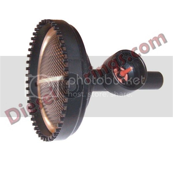

could my pickup tube in the tank be clogged?? i know that the plastic piece has broken off cause it almost runs out of fuel at 1/4 tank so i never go less then half a tank.

They have this stupid pick up with an umbrella valve for if the fuel gels and the bottom gets plugged.that valve can get sucked out.just something to look at.

Sully ill look into that man i appreciate that

OK so....... i replaced the Busted up plastic piece in the tank and removed all the stuff, was all excited, blew the lines out with air to make sure nothing else was clogged like the main pick up line was, everything was GREAT... till i started the truck and only gained 2 PSI of pressure, it now sits at 50spi and when im driving it only drops to 45 at most...... could my blue spring have failed?? im at such a loss, and i really cant afford to keep doing this...
