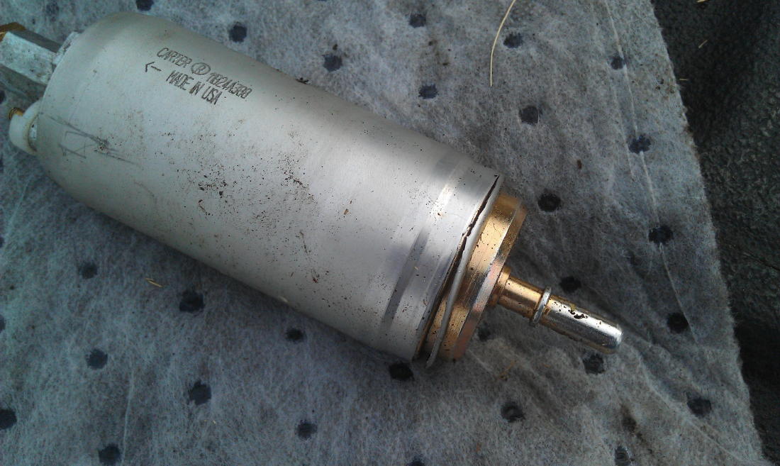

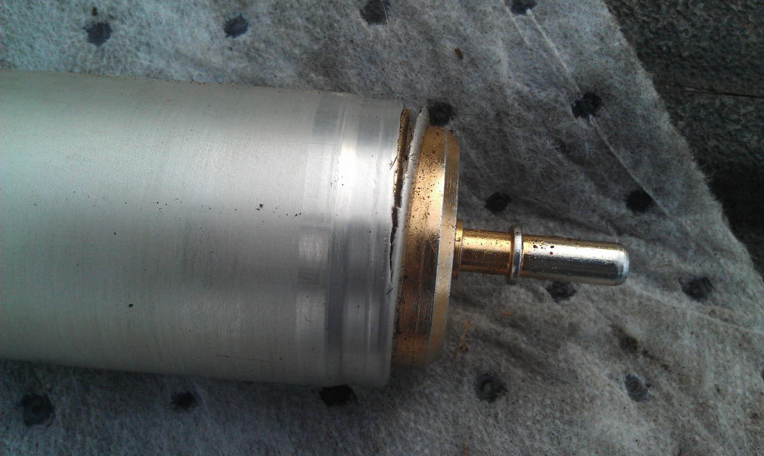

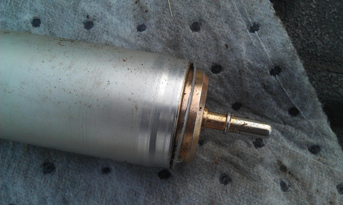

I ran a Carter pump on my truck for 8 weeks. Worked great until I noticed a big streak of wet stuff in my mirror as I was leaving a parking lot and I was suddenly aware of the strong odor of diesel fuel. (they were kind enough to give me a free replacement under warranty, but I've been running the Airtex pump since last July since that's what the closest store to my failure had in stock. The carter is behind the back seat just in case)
