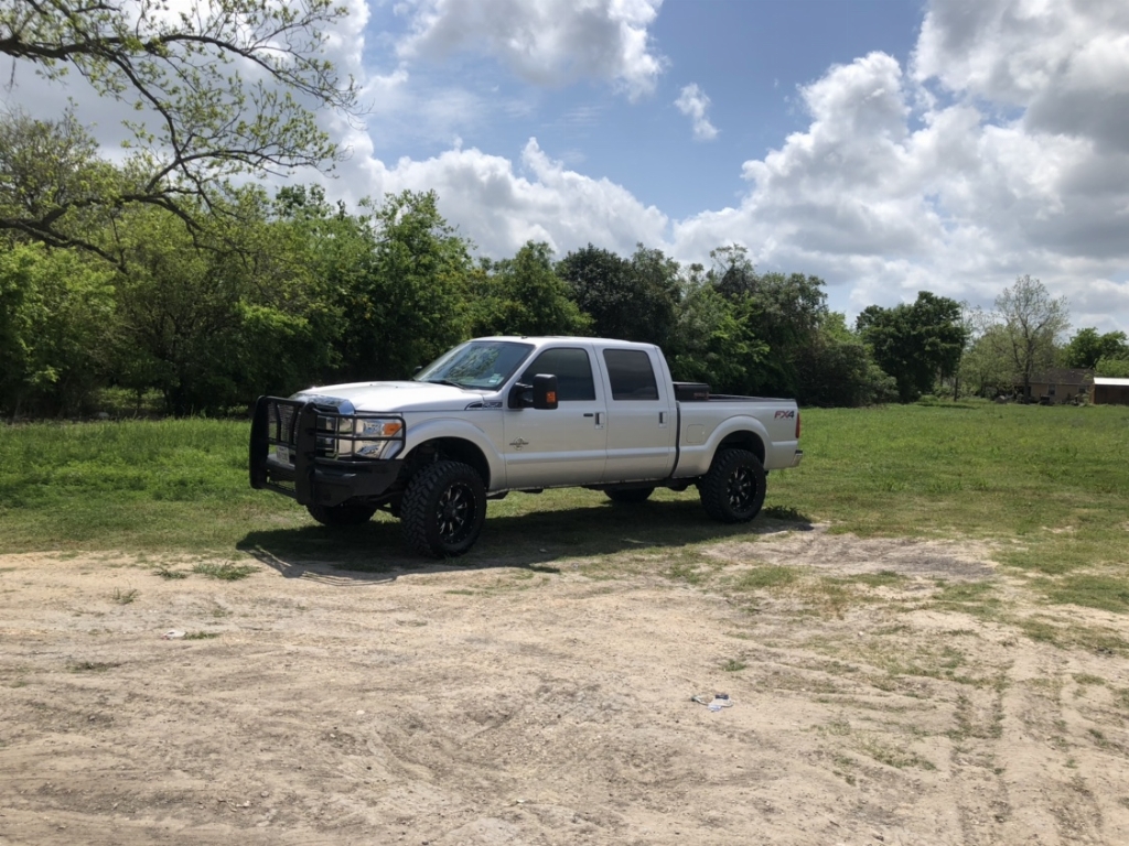

Hey guys. New to the forum. I’ve got a 13 6.7 that I just installed a 64.5 MPD budget turbo kit on. I’m not stoked with the lag so I’m hoping that a piping kit helps some with that. Who has the best deal on piping kits for the truck and what’s the best fuel pump option to max out stock injectors and 64.5mm turbo? I’m running no limit tunes on an sct shift on the fly set up. Truck is fully ******d.
