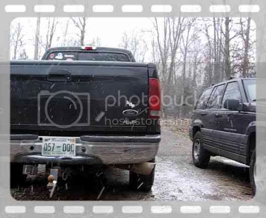

I guess I dont see the issue... Factory trucks running 12 micron go 250-300k on average with a set of injectors.
Photobucket links, sorry...
200k...
New injectors a week later...
I'll go with? Factory filter could use some help?
