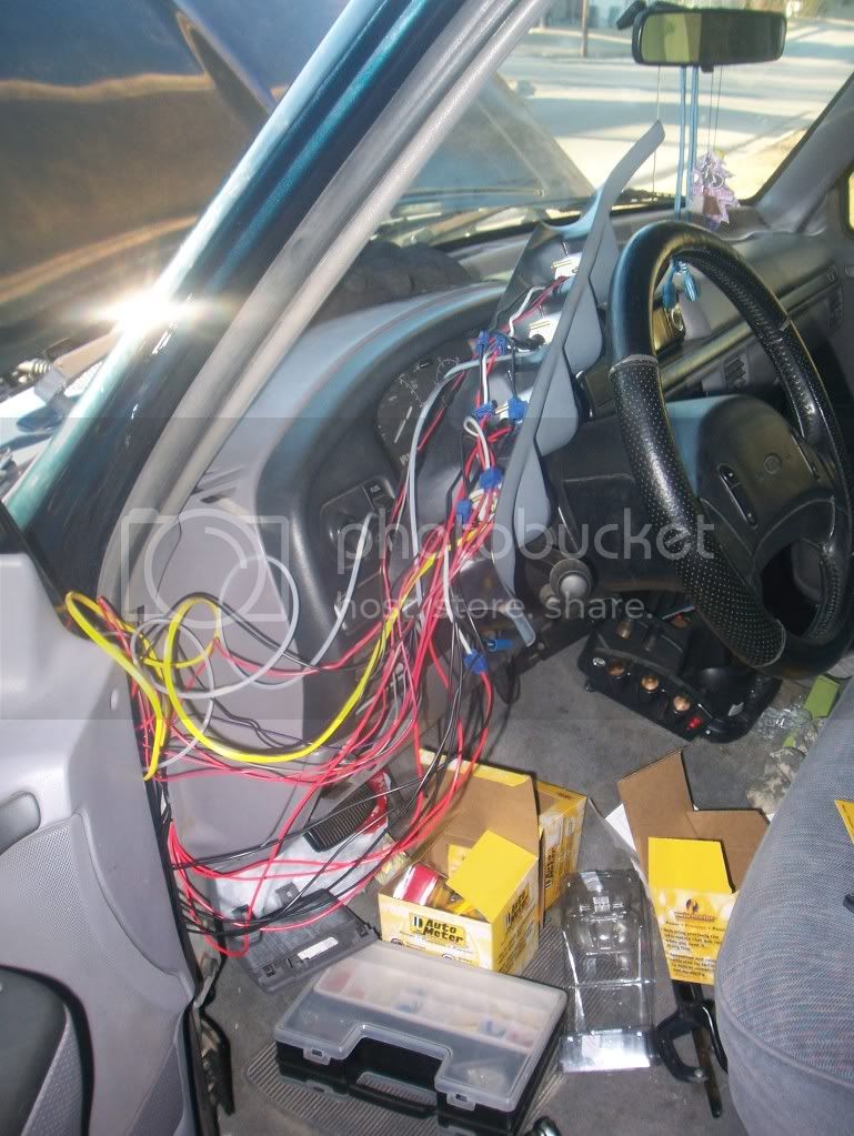

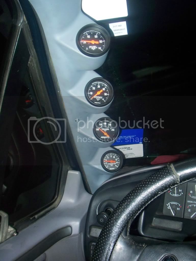

I am not going to lie it took some time but it is not that hard. I dont know what everyone else used but I think I used about 60-70 feet of wiring.
Good God! That was made way more complicated than it needed to be...
how so? I know everything but the boost needed power and lights. How can i make it easier? I got finals and then it is one on one time with the truck, re-wire, paint, clean, fix.

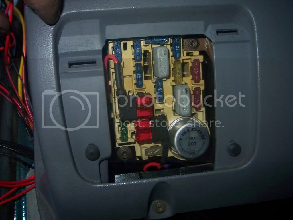

I did the same type of fuse tap. Except I used a male plug in and pushed it in beside the fuze. I never seen those things before. Pretty cool!

What Glowshift gauges did you get? I have the 3in1 diesel gauge and it was really easy to do. Just drill and tap a couple holes and run the wires.

I got them at autozone. It is a dual fuse plug with a 16 gauge wire coming out, iirc, so that you can splice in to it with out cutting in to it. I will try to post up some pics of it. They were less than a dollar

When I did my install I just used T taps into the fused side of the ignition hot and illumination wires. Fuse taps like the ones pictures are a better idea IMO, I don't care for the fuse taps that are just a little copper tab that you shove between the fuse and the fuse box. Plus, my local Napa rarely has the crap I want and I wasn't driving 1 hr each way to the big city for a couple parts.
Daisy chain the power and illumination wires to make things cleaner and easier to work with as previously mentioned. I've never installed Glow Shifts, but I've installed a couple sets of Isspro EV's, Isspro EV2's, and some Autometers. Just take your time and do a clean install. Also, don't forget that its a lot easier to cut 2" out of a piece of wire than it is to add it back in later :D
