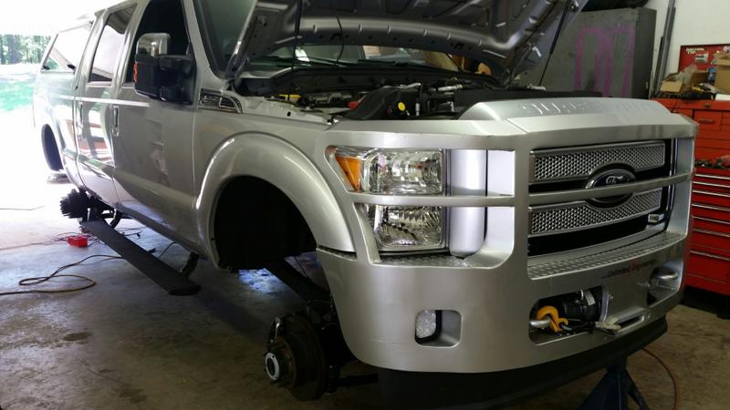

Since I need stability to be hauling and space for new 37" tires I needed to put all my stuff back on the new '16. So today, I got on it.
1st up was the rear suspension (traction bars, airbags, shocks, etc) but as I crawled under, the running boards were hitting me so they came off first. Anyone want a set? like new :)
Traction bars, installed
Airbags, installed, though still have to do the wiring
Rear shocks, installed
Fuel tank, out
Paint Titan Straps black
Sanded all the rusty stuff under the truck in prep for paint. IDK why Ford doesn't paint this stuff :shakeshead:
Today
Paint all that rusty stuff.
Shift the cab back as far as possible

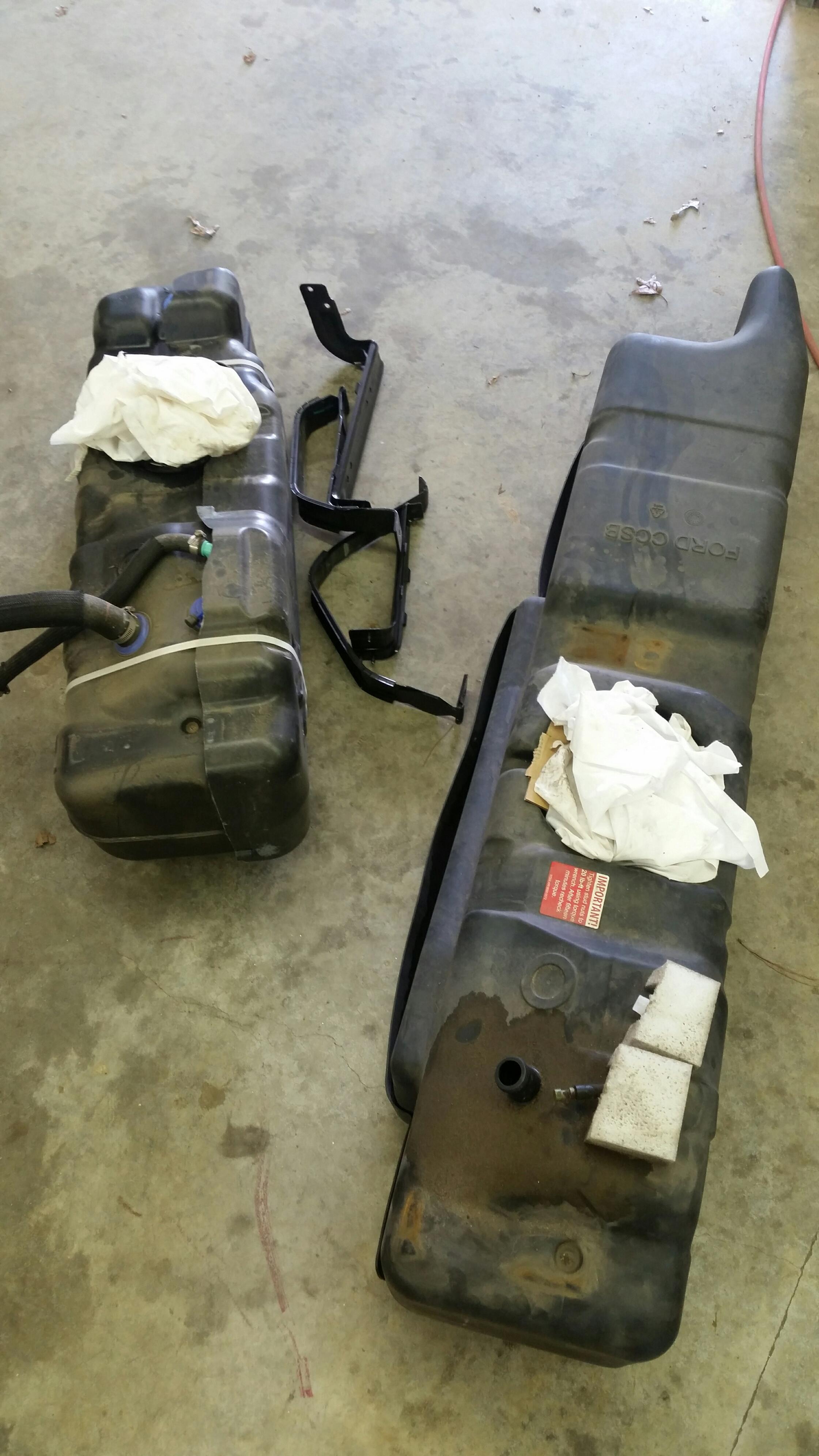

Put the 50 gal tank in
Leveling kit and all it entails
Front shocks
Amp steps
That ought to be a good start anyway.
Pic is stock tank vs Titan 50 gal. What a difference, huh?

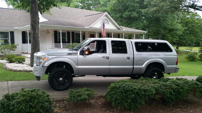

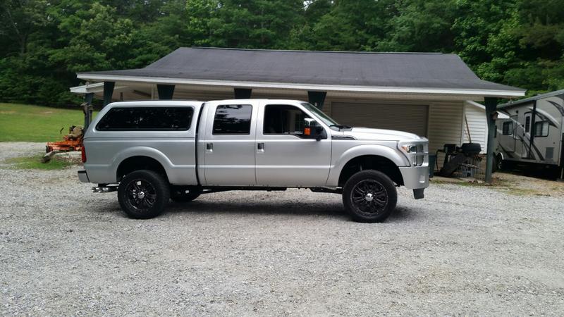

I tried to get a little more clearance for bigger tires, but only got like 1/4" total. Looks like I'll need to hammer a little on the bottom lip of the fender where the edge of the tire will make contact.
Swampfox
Apr 26, 2013
294
TN
I have a 4.5" carli kit with 35 ridge grapplers and 22x10's and it clears enough for comfort. No way it was working on the leveling kit without excessive trimming. Looks good so far.
TrickTruck
May 7, 2012
977
4
Simpsonville, SC
I've been running 35" Terra grapplers for 4 years now on a leveling kit. No issues and they are wider than the Ridge grapplers. The only time they come close is when turning the outside edge of the tire almost contacts the bottom of the fender.
My theory is that the 37" Ridges will fit since they are narrower than the Terras by 3/4", I've moved the cab a smidge and will do a little hammering when I put the flairs and mudflaps on.
Bear in mind, my wheels are 10" wide and only have a +10 offset, unlike many with 20-40mm of offset.
We'll see...
If I can get them to fit, I think they'll fill the wheel wells nicely :)
