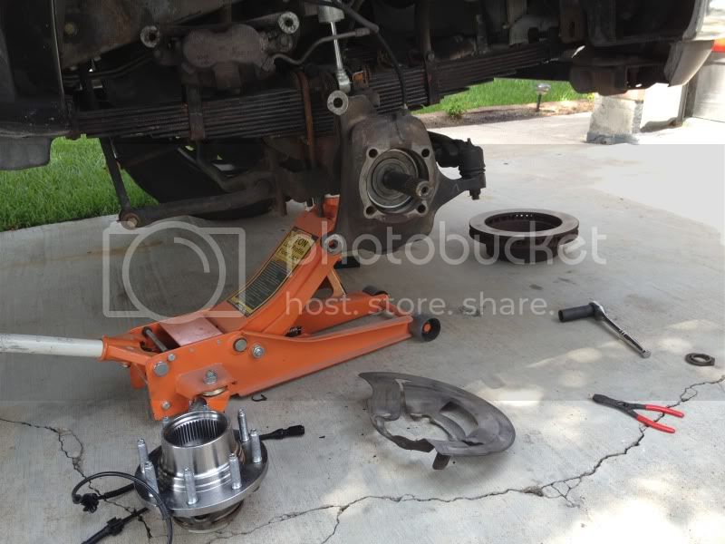

I assume the shop is talking about the sway bar end link bushing, you can replace them with some energy suspension bushings
and here is a pic of mine with the hub off, its simple to replace in case you want to tackle it on your own next time

holy leaf springs!!!
Courney, its the part that goes up on the far right.
