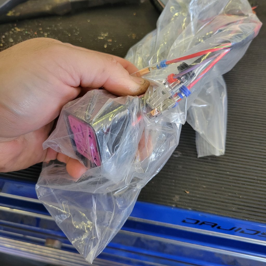

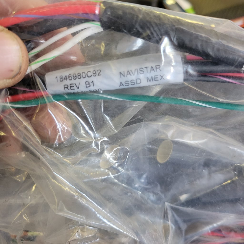

Usually the pins back out of either the green or black plug.. I just spliced in a new set 2 months ago, I'll grab the part number Monday.
Remove the connectors, pull the red lock face off and inspect all of the pins, make sure they are locked in

Navistar
