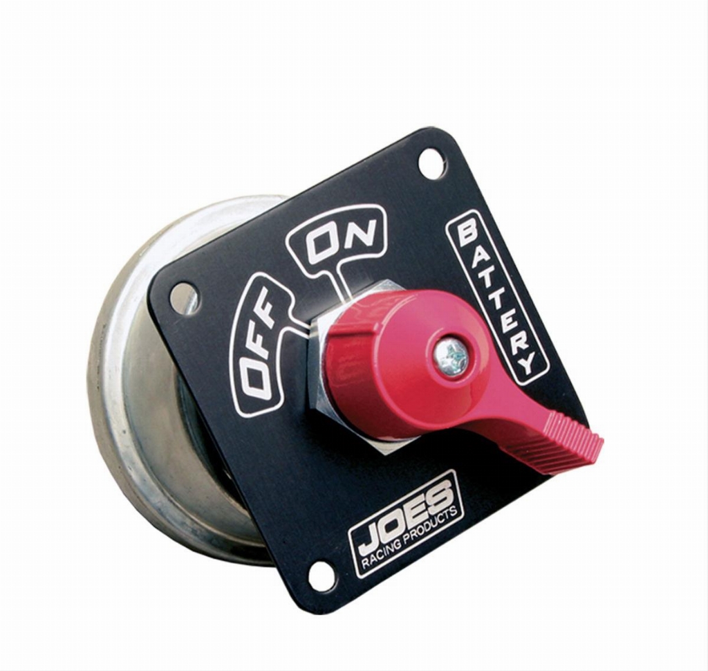

I run a battery shut off switch through the firewall to the dash where I can reach it conveniently. cables go to the relay/battery wire.

I've seen the manual relay switches,
but I'd rather keep the truck on the factory system ... (wait to start light)
just kill the live power lead to the relay... instead.
