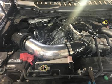

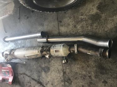

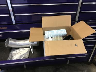

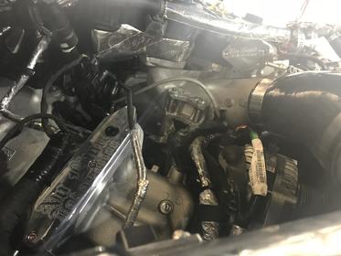

I pulled the trigger and did the full D. E l ete on my new truck. Didn’t go as smooth as I had hoped, so I have to give thanks to Mike and Jeff at No Limit Fabrication, for coming to my rescue at 7 pm on a Saturday. They quickly got the tunes lined out and didn’t leave me hanging. All of the No Limit parts fit perfect and leak free. I went with darkside tunes, and well I have no doubt we will sort them out. The engine runs amazing, but the trans tuning leaves much to be desired. Probably mostly due to relearn.
