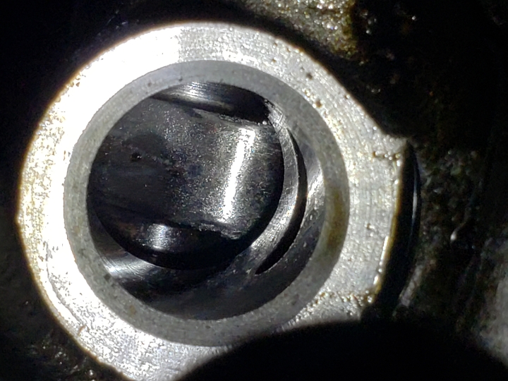

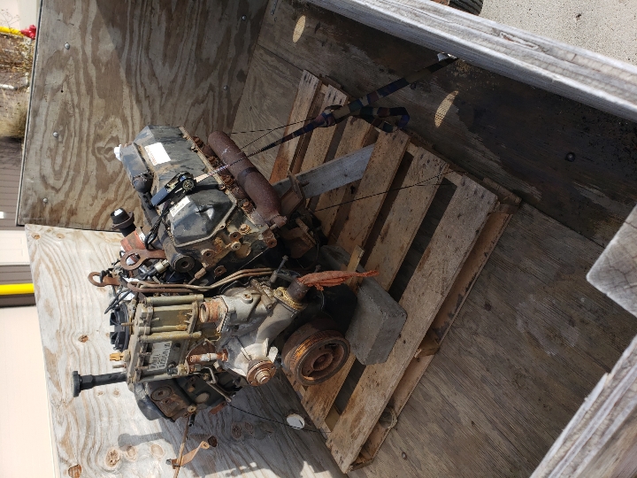

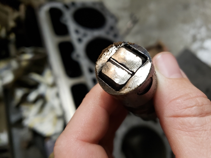

Got this 01 for $500, supposedly was pulled for broken push rod after injectors were installed had 180k on it when I broke it down for a bad lifter and it chewed up the cam so I will have to get a new one or aftermarket one

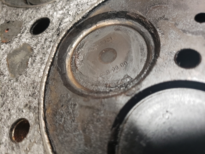

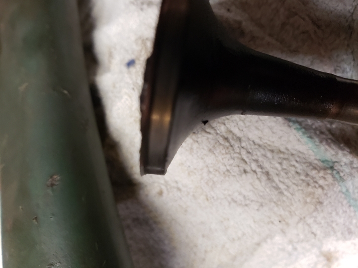

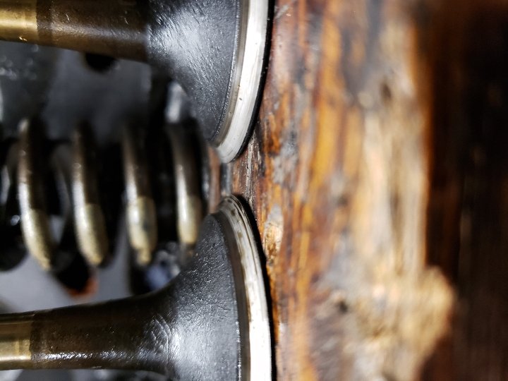

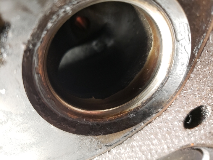

Also all the intake valves were pushed into the seats pretty bad first 2 were the worst ones you guys ever seen this? Never seen this I would think it's from hydrolocking the engine but I know on 3512 cat engines they blow the injectors through the valve cover if they hydrolock
Sent from my SM-N960U using Tapatalk
gwunter
Jan 3, 2013
1,137
Logansport, IN
Never seen anything like that with the valves working their way into the head like that. Seems like maybe there is something else that contributed to that.

The guy I bought it from said it came with the truck the previous owner had injectors done at for and went to get it the next day and said it ran really bad so for fixed it said they changed the motor because they found a broken push rod and lifter. Dont know if I buy that but I did find a broken broken push rod ball in the pan and number 8 was missing a lifter and pushrod and rocker.
Its been run too hot for too long. If you were to continue too run it, with too high of egts, the seat would separate from the stem, and then you'd have a seven cylinder 7.3l, lol.

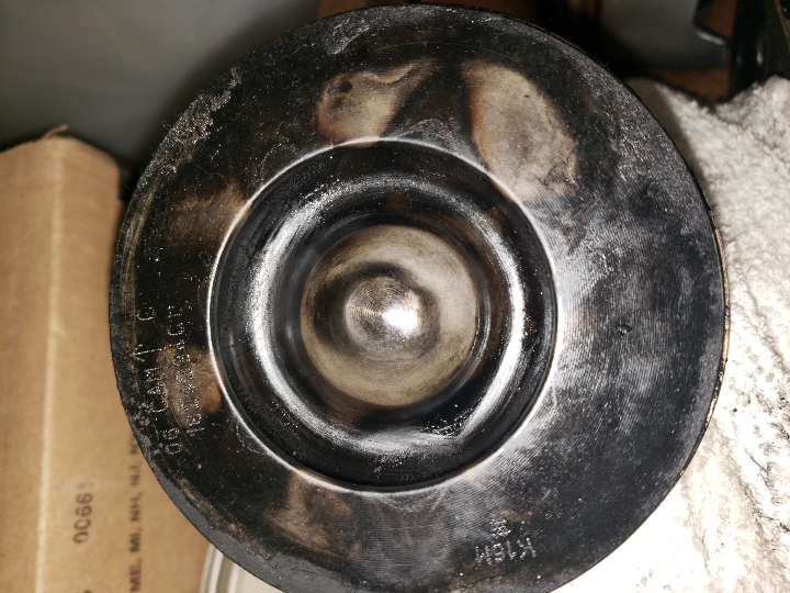

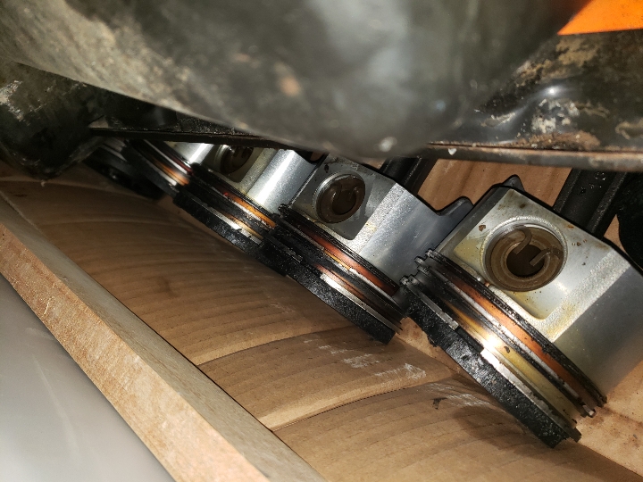

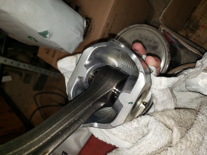

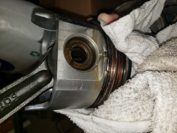

See I was curious if it was run hard but I didnt see alot of heat in the pistons on the back side or on the sides of them
Big Red Bus
Jan 5, 2020
20
The bakken ND

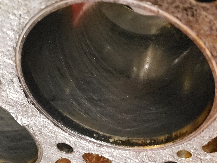

Is there any erosion on the tops of the pistons?
Sent from my SAMSUNG-SM-G900A using Tapatalk
Nope pretty clean no issues, no pitting no melted or distorted areas from heat that I can find rods are straight enough by eyeballing them that I cant see issues, all the bearings but 1 look new. All that I found was the lifter on the exhaust and the intake valve train that was missing when I got it, that was the first piston I pulled since both lifters had issues on that cylinder. Figured I would see something but there was nothing

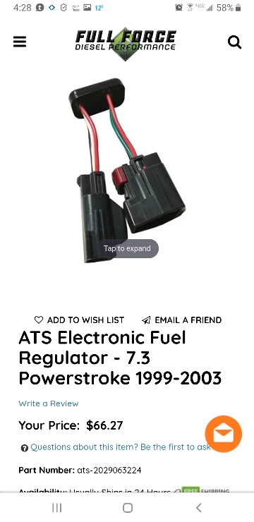

Was building a parts list this week and seen this, is this an actual boost fooler? It says it's a fuel regulator, just curious will probably put inline regulator in anyways. Also from what I can see on t4 kit I should be able to bend a hardline and install MORB X MJIC fittings in the heads and flare the ends on the hydraulic flaring tool at my old job.

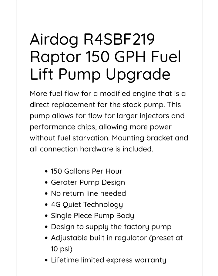

Has anybody used these? says direct replacement and no need for return so I could install a filter and go away with stock fuel bowl? Any thoghts? I'm sure that the return line ties to the pump and just holds on a regulated curve
dsberman94
Oct 9, 2013
11,571
65
Pennsylvania
I don’t know what that is but I stay far away from anything branded air dog or fass.
The cnc fab line is priced right that it wouldn’t even be worth the time to mess with one on your own.
Riffraff for a boost fooler and it won’t read correct through the trucks computer anymore so you’ll need to find another way. I T’d off the front of the ic pipe plenum temporarily but got a bung welded into the ic pipe.
