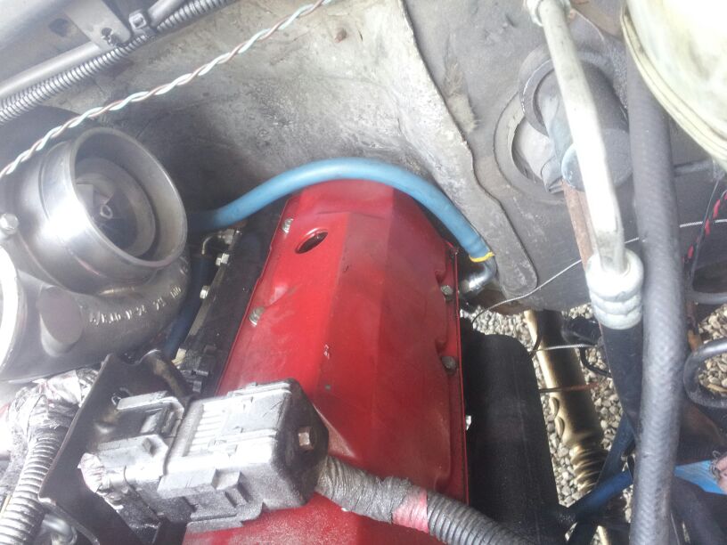

Water lines for turbo the front water connection runs to the heater hose for the cab heat.

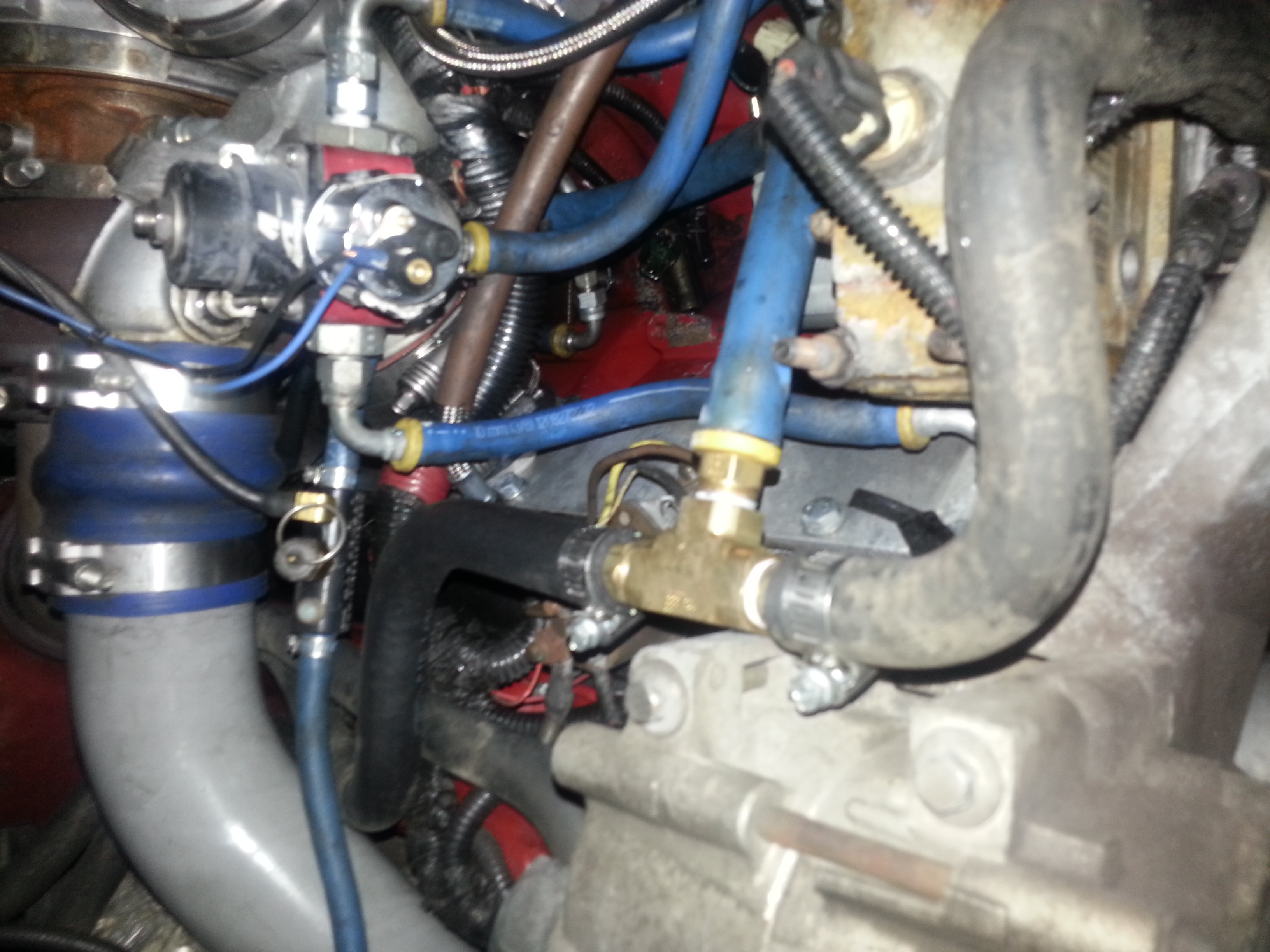

Here is how it is tied in.

Yes supply from the top... I just cut it.. added some hose and hooked it to the top.. then the other end to the bottom.. no t... in it at all.. one thing good about this way I have heat fast...hope this helps..
