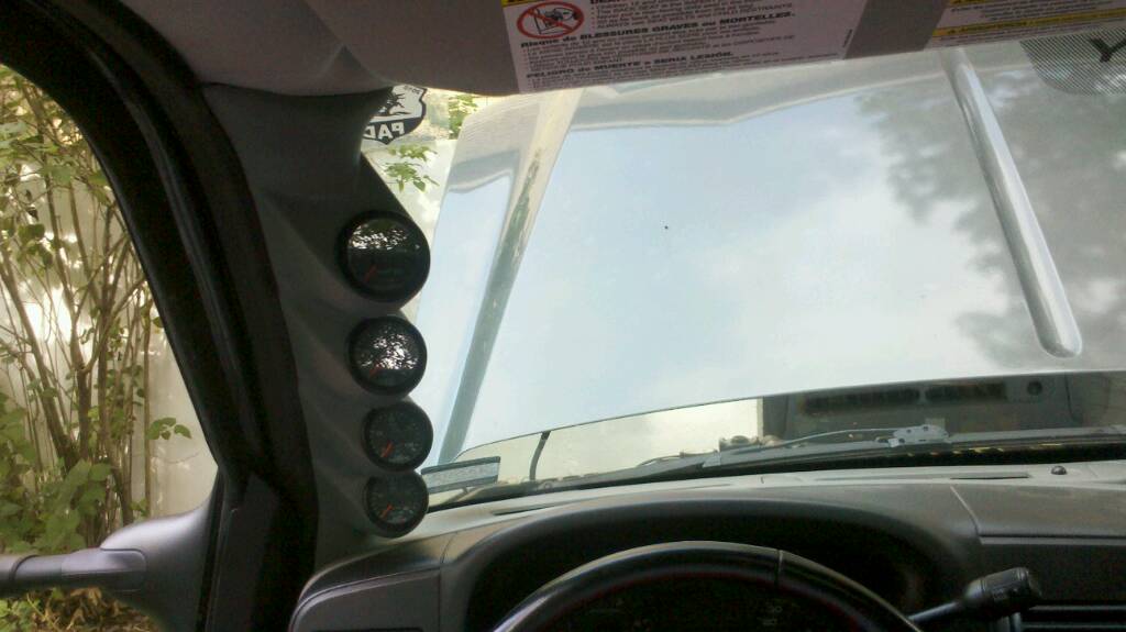

On a 6.0 I feel it is an absolute must to monitor fuel pressure,oil temp and coolant temp as well as the standard egt,boost, and trans temp. Personally I have 4 gauge pillar with isspro performax series gauges. Egt, boost, fuel psi, and trans temp. I also have a scangauge that can read anything the computer monitors. I usually display oil temp, coolant temp, ficm voltage, and intake air temp ( with the zoodad while you are moving it reads pretty accurate outside temps. so I use it as a thermometer)

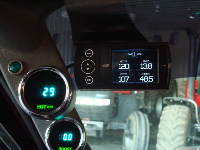

i've got both analog gauges and an edge insight CS. I'm monitoring egt's, boost, trans, fuel pressure, and HPOP pressure by analog and then i'm monitoring enging oil temp, coolant temp, FICM volts and battery volts with the edge insight. Here's what my setup looks like....
