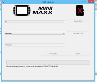

I am trying to update my friends MiniMaxx. No matter if I use auto updater or manual method, the files are larger than the 2GB SD card will support.
Any ideas on how to fix this? See attachment.

Same issue here. I ended up just loading the files I needed. E.g not the dodge ones. Interested to hear the solution...

Format the card(do not quick format) make sure its FAT format. Then use the updater and load the files u need

Did u only load the files for your truck?
read above. yes i ended up doing that. still doesnt answer the question why all the files don't fit on the card.

I had the same problem awhile back. I snooped around the forums on the H&S website and figured out how to get mine to work. My problem was I didn't have the latest "H&S Updater" installed on my computer and also I needed to update my Java. Best I can remember that did the trick for me. And I believe the new Updater doesn't update all the files, just the ones you need it to. Saves space on the card that way. Again best I can remember.

because Ford has released so many updated flashes for the 6.7, and H&S has a copy of every stock file in the update... it has recently gotten so large that EVERY SINGLE H&S update file won't fit on most 2 Gig SD cards... Most 2.0G cards only actually hold ~1.8-1.85G of data to begin with

format the card. use the updater and instead of doing the full card download, pick the tuner-card-model and only update those files.
