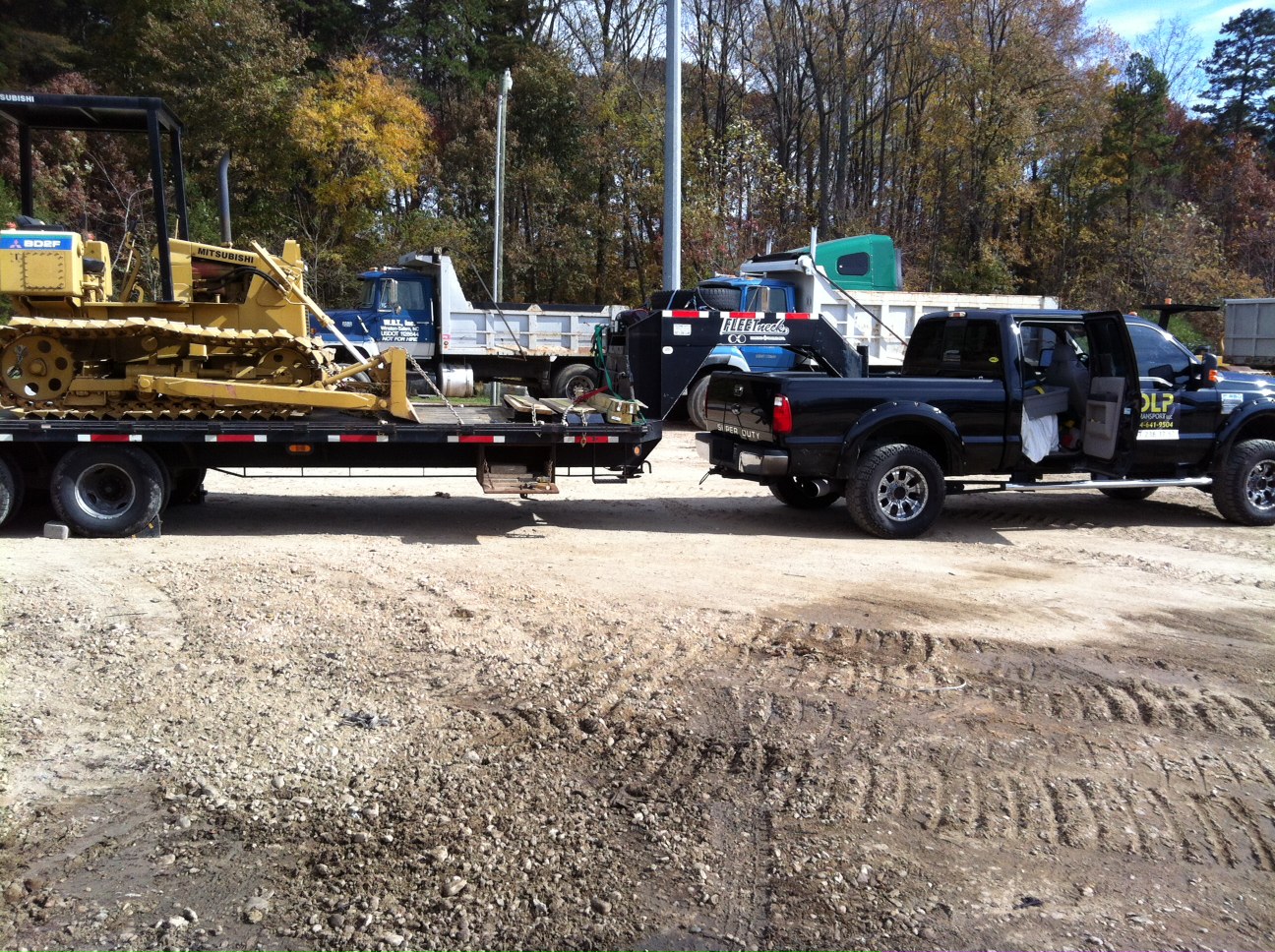

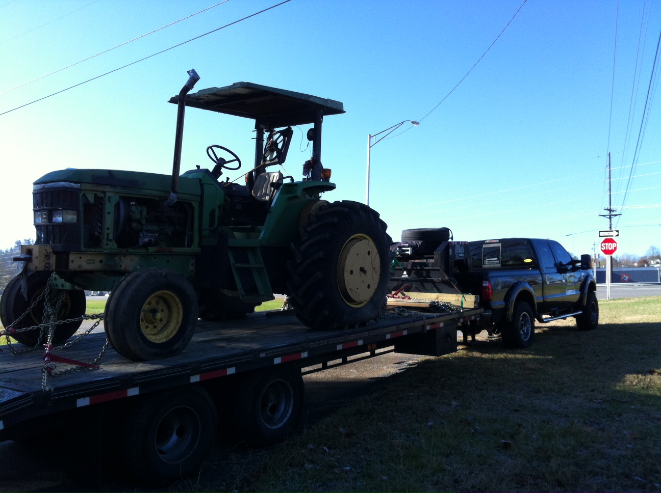

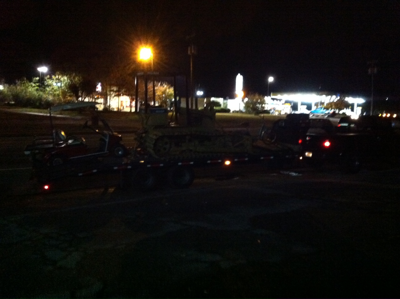

Here are some pics from the trip I made using Matt’s tunes. Sorry, I forgot to take a picture of the skid loader that I towed for 358 miles.
