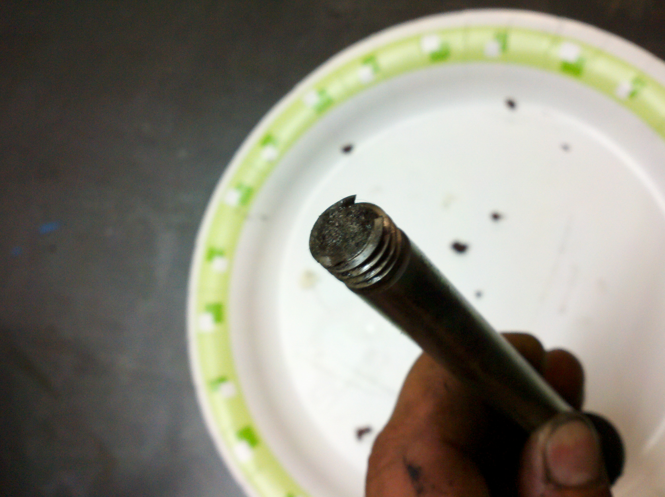

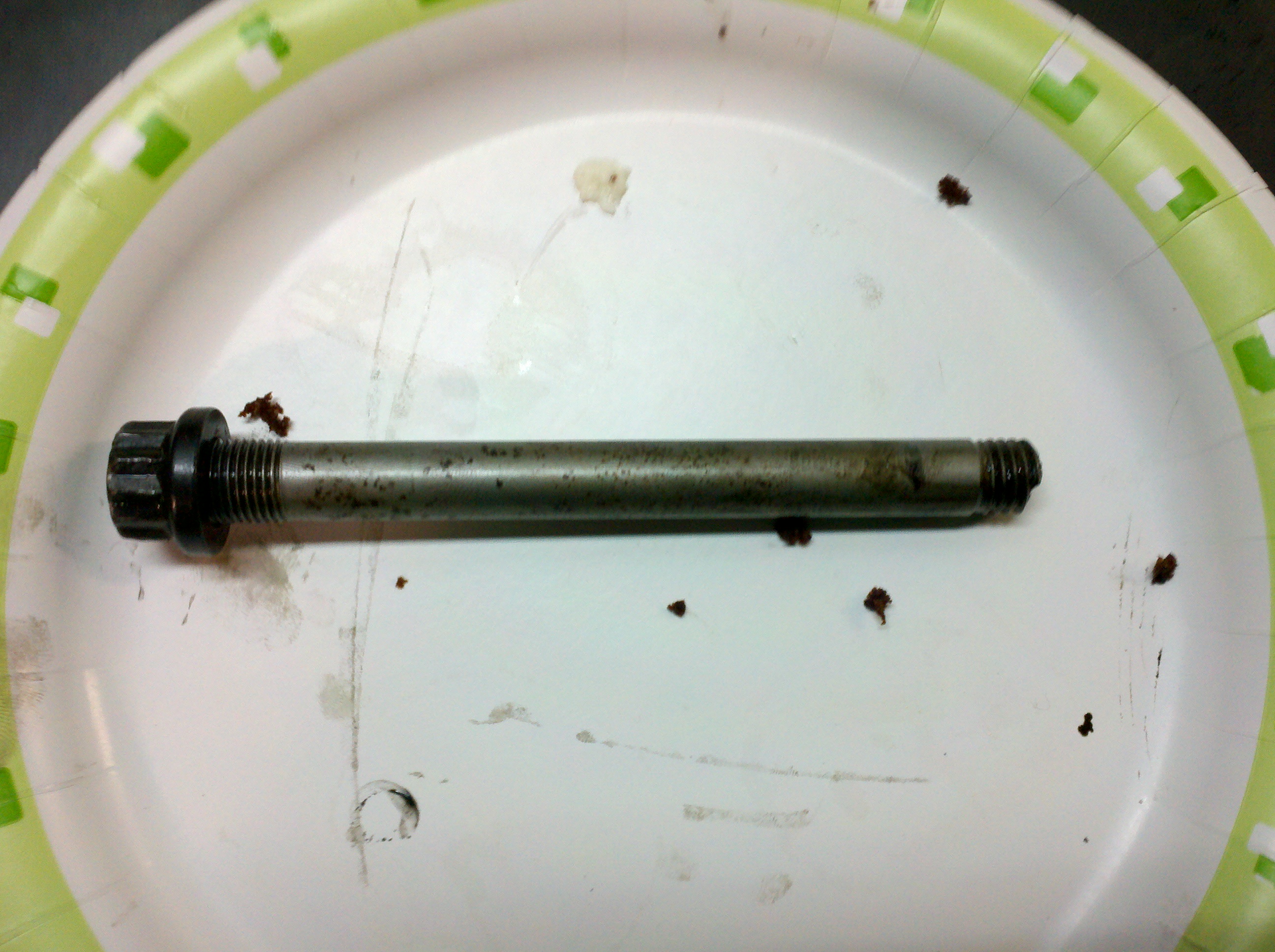

Tom S
Moderator
May 20, 2011
3,365
Do you think the stud was defective or was the torque wrench being stupid.
STAX
65
Same thing happened to my buddy when he was torquing down H11s on his 7.3... when it let go, the torque wrench came flying up and damn near knocked him down. Hope you get it all squared away.
04stroker
2,021
Sarasota-Bradenton, Florida
Can't be positive but my money would not be on the torque wrench. It has been calibrated and torqued several other sets and been just fine. It had done a couple studs before this one. Just sucks because if the head has to come off got to buy another gasket and fire ring set.
wint
609
Scipio, IN
The metal in the stud where it broke looks pourus (SP?). My money is a faulty stud. Im not that big and the torque wrench isnt that long no way i should have been able to do that as easy as i did.
