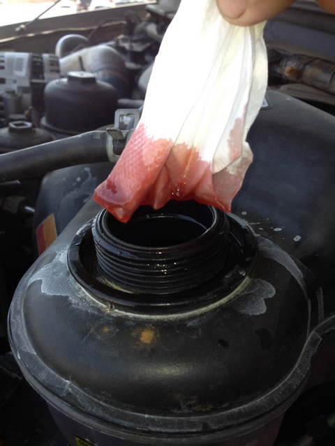

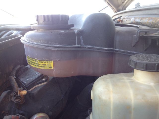

Hey there, issues after issues I feel like, almost regret getting this powerstroke , but I'm looking at the light at the end if the tunnel, the 6.0 updates been done, like 3-400 miles ago, before I got it, thinking no more issues, but I done a coolant flush, after so long of driving I notice a red fluid on top of my coolant, I'm thinking tranny fluid pulled the dip stick notice hardly anything on the dip stick , I checked it cold , possible I read that the tranny cooler busted in the radiator.? Possible change the radiator?

How do I do this? Yea cause it looks like tranny fluid, I love this truck but I'm scared of it now

I'd say it is possible. I have seen it happen before and the coolant looked like a strawberry milk shake. So what happened is some bozo replaced the trans and blew shop air pressure in the lines to blow out all the burnt fluid and metal. I cut the tank open to see what happened. When he did that it split the seam on the cooler in the radiator.
I think to check for a ruptured cooler I'd remove the trans lines and pressure test the cooling system and see if any coolant comes out the connections.

It sure does smell like ATF , looks like the original radiator, at 173,000 miles

Thanks I'll order a new radiator, so much for a coolant flush 200 miles ago , looks like I'll do it again , I plan on putting the new radiator in and take it to a shop and have them flush my tranny , is that a good way to do it?
