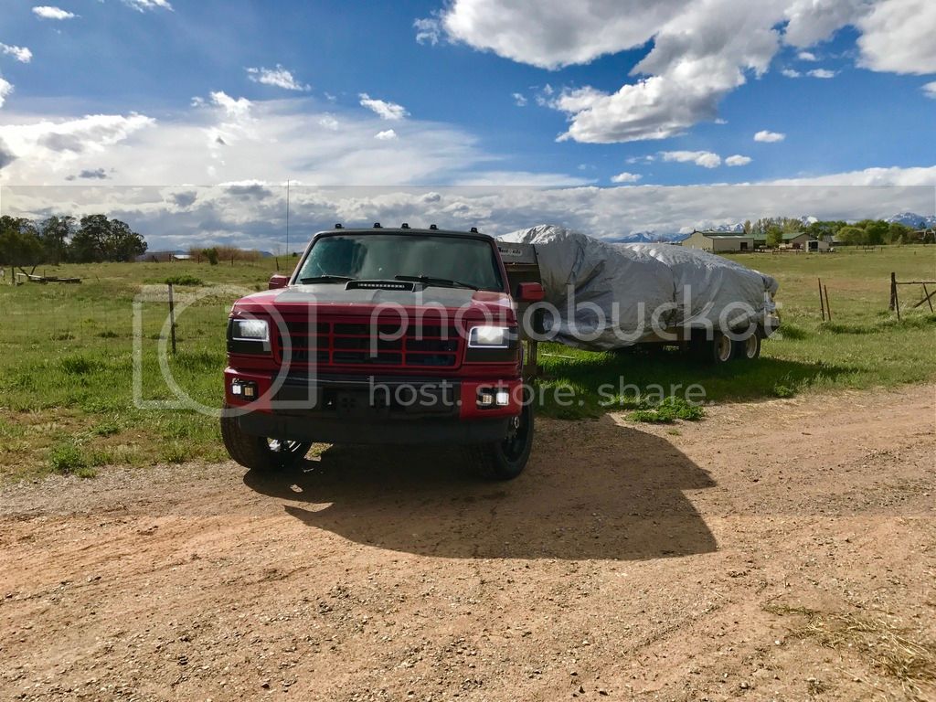

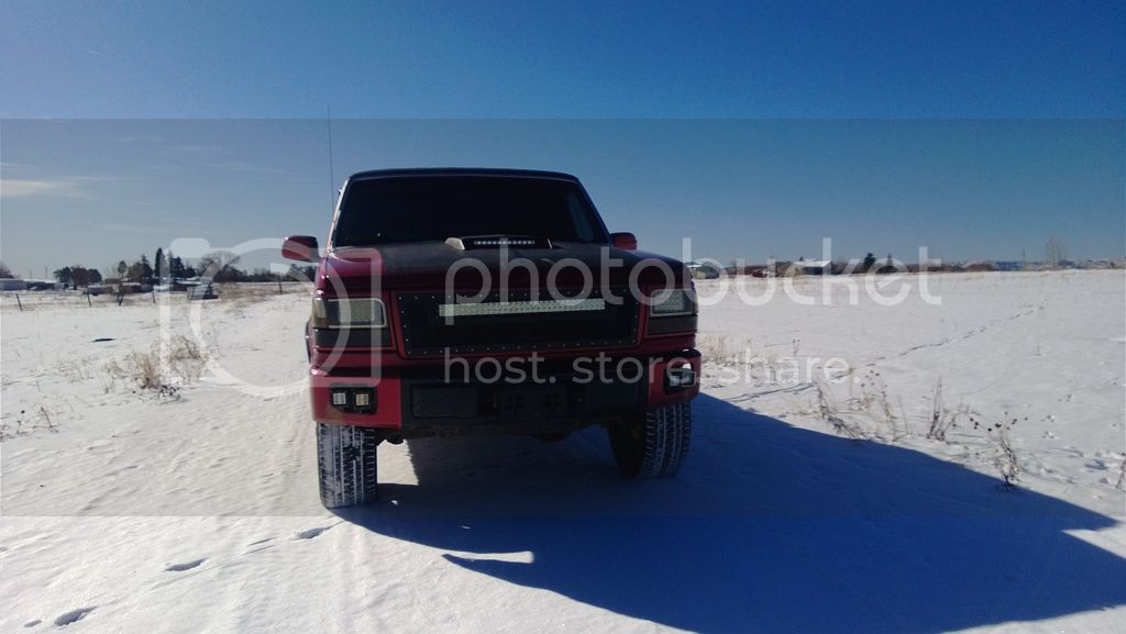

smcox1
Sep 14, 2012
1,661
Putting some serious thought into this idea: Get new Depo housings, dremel out the back and install a Truck Light or JW Speaker 4x6 LED retrofit sealed beam headlight into the back of the housing. Aiming would be something to worry about and being sure it is sealed. Looks like it could work. Get the proven, reliable sealed beam headlight installed and aiming gear still works. About $350 for the headlights.
I know this is a few months old but I made the headlights you described and have been using them for the past three years or so and they've been awesome. I used the sealed beams from oracle though.
