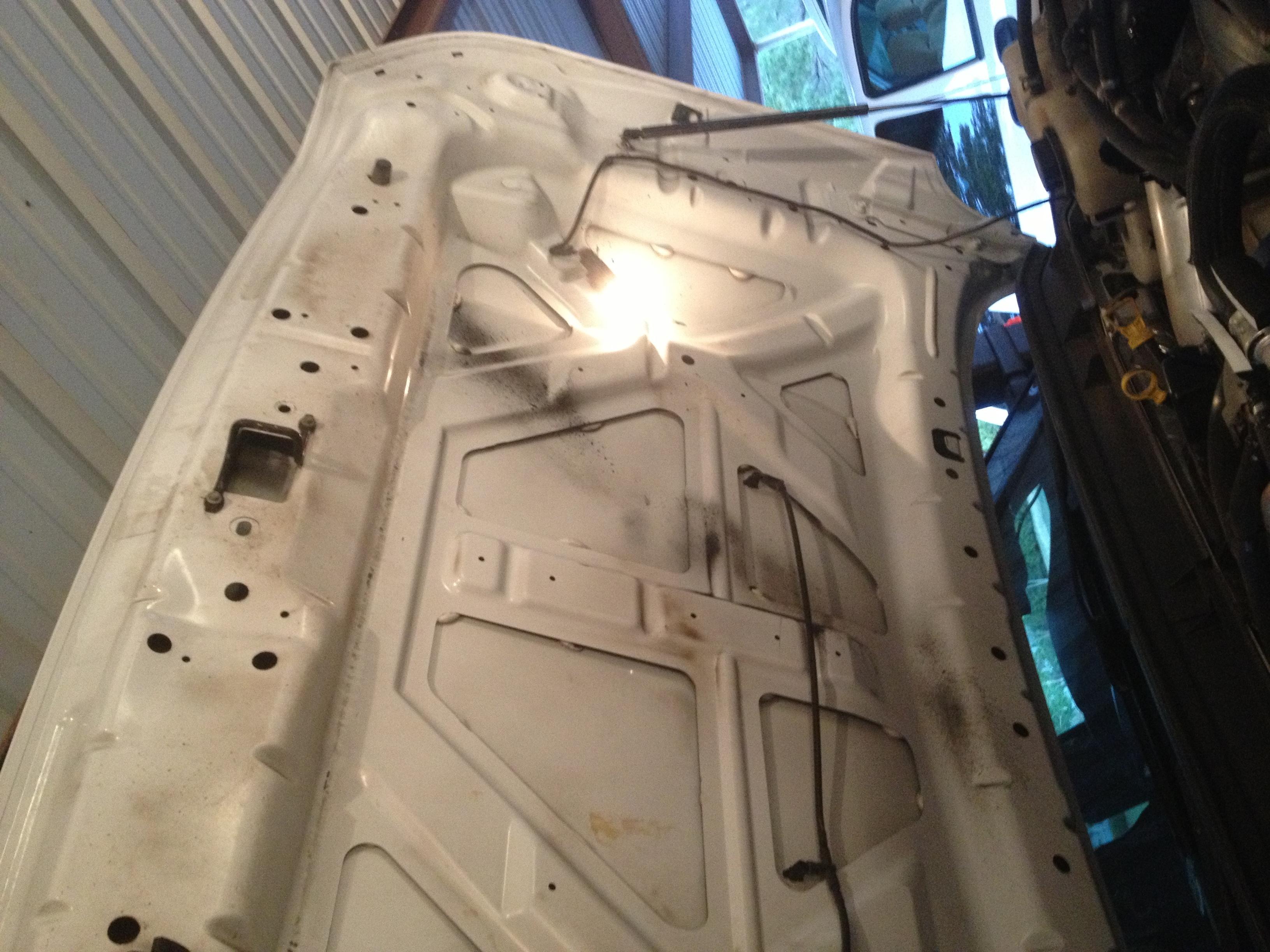

Driving to work this morning with cruise control set at 75 and all of a sudden I hear a bang or pop of some sort and black smoke is pouring out the tail pipe and I feel the truck loosing power. A week ago I installed mini max, intake, and exhaust. Under the hood is a small black streaky area of black oil. Looks to have come from the turbo. Truck still runs but a little rougher with no boost from the turbo? Has anyone had this happen or know of it happening? I had it on tow level and do not rag on my truck!

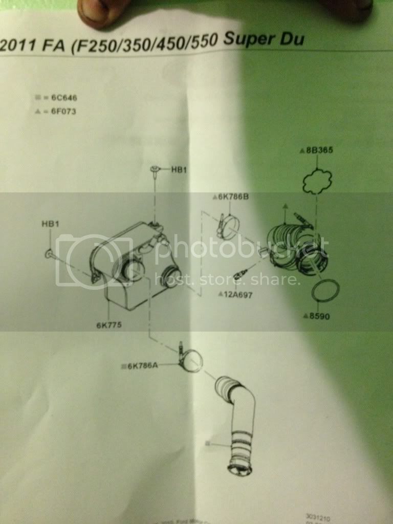

Well the op got his truck going again it was one of the pipes from the cooler that's on the drivers side of truck it split in half. The part was 130 dollars dealer had it in stock.
Mpoage
1,017
OKC, OK
Those plastic ones do have a tendency to crack or come completely apart. I've seen it several times on cab and chassis trucks here at the dealer.
