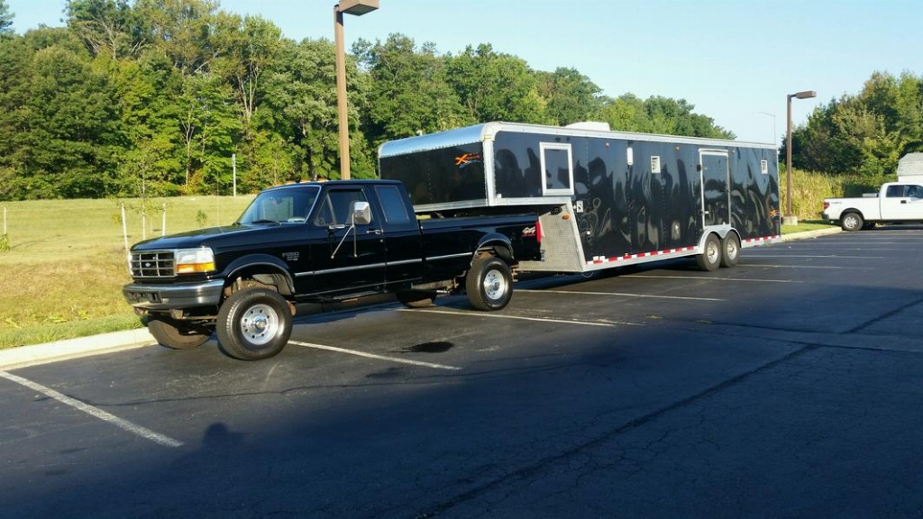

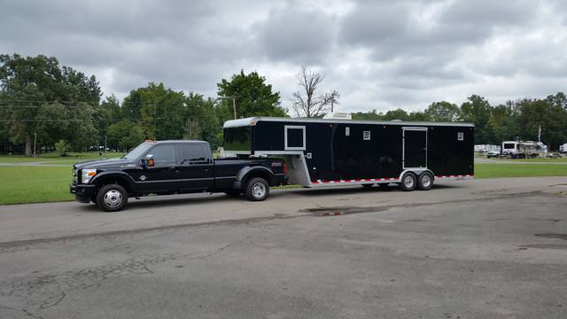

I was in the same boat. I was going to get a '16 SRW and I'm glad I didn't. The DRW truck hands downs. Do not get the SRW truck. I thought the same thing, I only do a few trips a year
My '97 is a SRW and was towing a 34' enclosed GN trailer with race and golf cart. I came in at almost 21k. As you can see in my sig, the '97 is modded.
Did the '97 do it...sure with no problems. Did it brake well....yes. But if I had to make a evasive maneuver, the pucker factor became present. At the end of my trip, I was worn out.
Then I got my '16 F350 DRW.....holy ****, what a difference. Didn't notice the trailer was back there. Handled curves on the highway so much better, the stability was awesome.
I still own the '97.
With a 7800 rear axle weight, what tire do you have that is rated for almost 4000lbs?
Once you tow with a DRW, you will never tow with a SRW ever again.
Before:
After:
