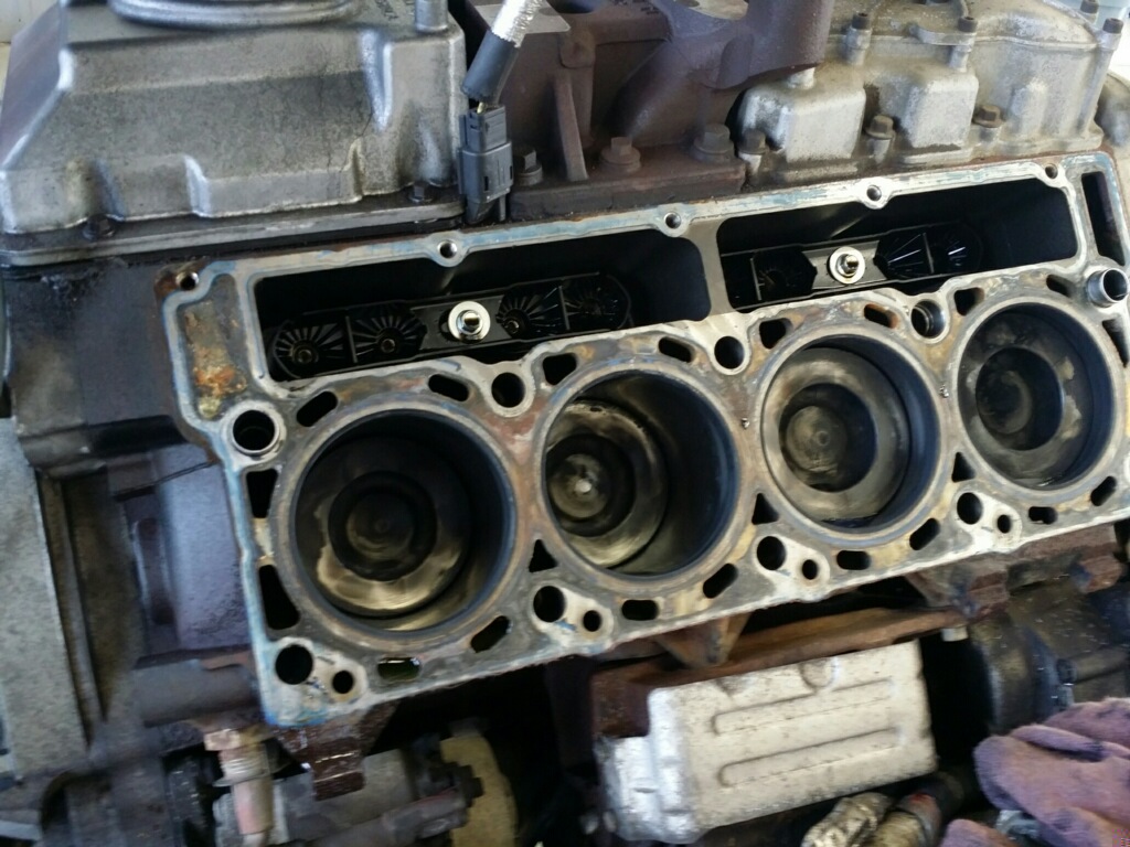

Got these pics today of all pistons on right side cracked. I don't know what to do, long block or rebuild.
I would have to ship whole truck back here and get into it.

I'd pull the pistons and have the block checked at least. No reason for a long block unless needed. If the block is good, just upgrade pistons, replace bearings, and rods (if wanting to upgrade) and re assemble with it studded and do some valvetrain upgrade (springs, retainers, push rods, and new lifters). Let me know if you need some pricing :thumbsup:

Tell them to throw it all in the bed and trailer it to Morgan. No way in heck would I pay 17k without letting one of these aftermarket guys building 10x better than what that dealer would do....seriously for that price get it to one of theses aftermarket guys... You can have a solid motor with better parts outa a vender here
alradco
Jul 26, 2012
953
If you're going to spend 17k might as well have a motor built by a reputable shop. I'd pull the truck out.
Stroked777
Apr 16, 2013
3,202
Casper, Wyoming
tell them you will pick up the pieces and bring it to a reputable shop, you will save money in two ways, the motor will be cheaper than 17k to build and two it will already be apart so you will save labor at the shop you bring it to LOL
B585Ford
Mar 17, 2012
2,730
WV
Shipping probably wont be as bad as you think if you look at the right venues.. I would have towed to a reputable place and have them fix it. PM me if you want help finding shipping.
Tom@BigTimeKustomz
May 15, 2012
4,131
Bayville, NJ
Agree with everyone's post. Take it to an aftermarket shop like Midwest or River City and let those guys build you the motor. If no warranty on the truck, I wouldn't let the dealer do it. Best of luck!

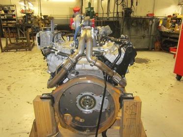

Looked long and hard at this. Also the dt swap.
This non egr maxxforce 7 is very interesting. Like the bolt on single setup for one thing.
