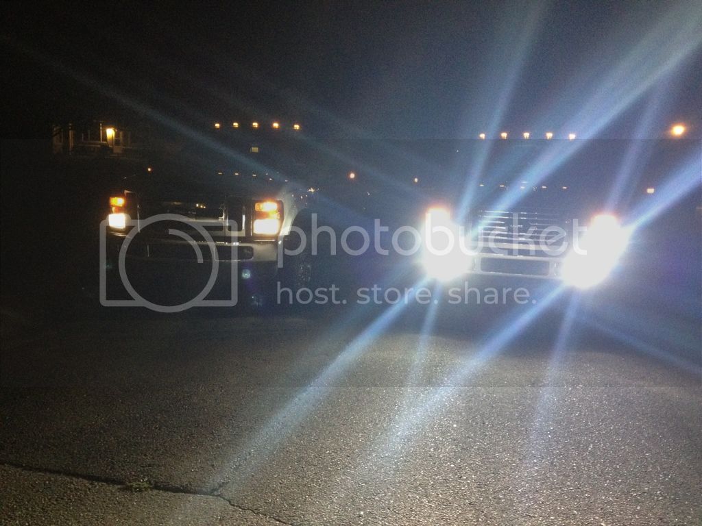

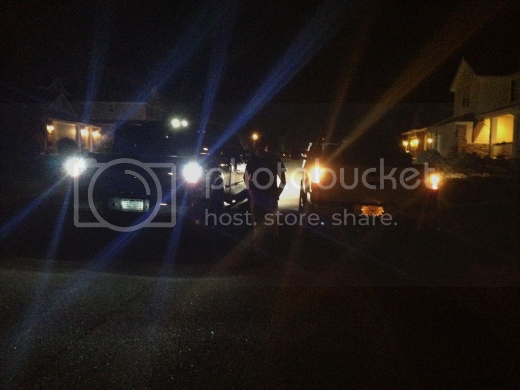

The color rendering factor makes a pretty big difference for some folks, that is the other advantage to the lower color temperature other than the little boost in usable light output.
Things are easier recognized at night now comparatively?
Yes, there is a lot better night time recognition. I may be tempted to try an even lower color temp the next go round.

You can only go lower to 4300K there though, and then it starts working against you again because of color. There is honestly not the much difference between 4300k and 5000k though to make it worth it for replacement bulbs. Now if you were getting the kit for the first time and it came down to it, then the little bit of difference would be worth it.

I did the 4300k and would not go any higher. They are WHITE no blue tint at all. I hate the blue look and besides it is a loss of light and definition. For anyone interested, here is some good reading on Blue lights. Daniel Stern Lighting
