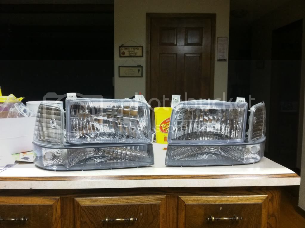

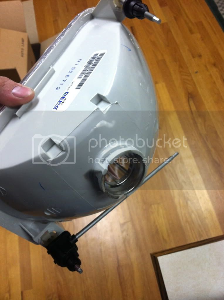

So I got the housings here at the house, and actually was very surprised by the quality.

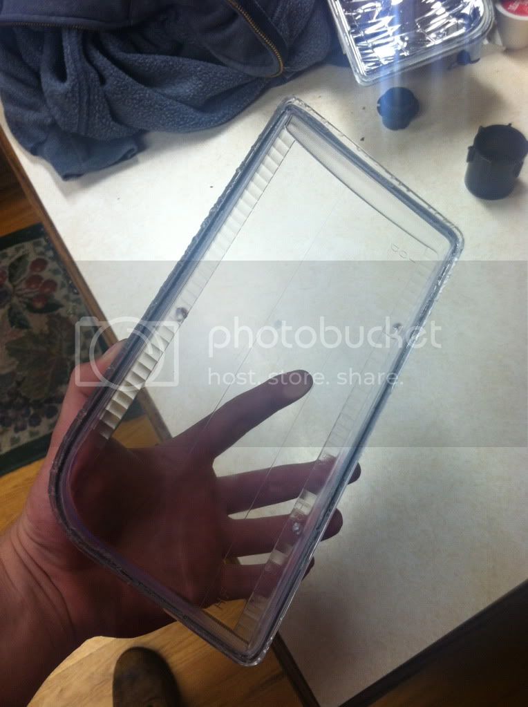

Now was the time to take the lenses off the housings so I could put the projectors inside the housings. This took a lot more work than I expected, but after about an hour and putting them in and out of the oven I finally got them off. The main trick I learned towards the end was to leave them in longer. I was afraid I would melt the housings, but even at 275 degrees and 10 minutes there was no issues.

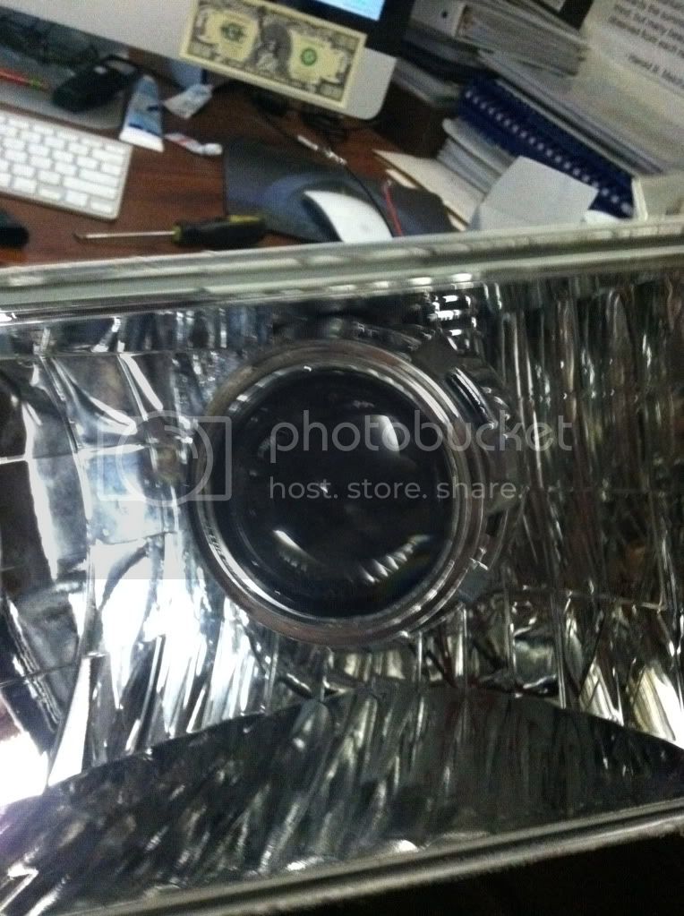

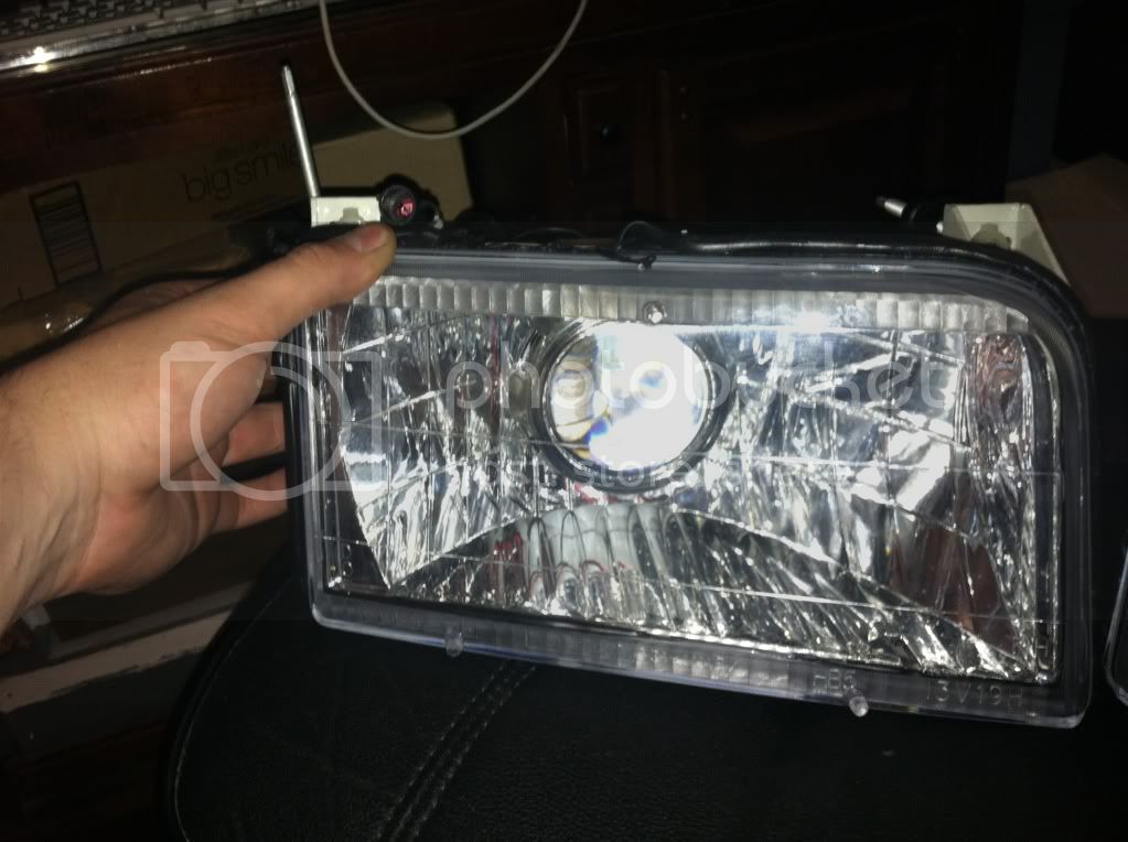

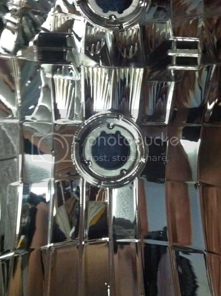

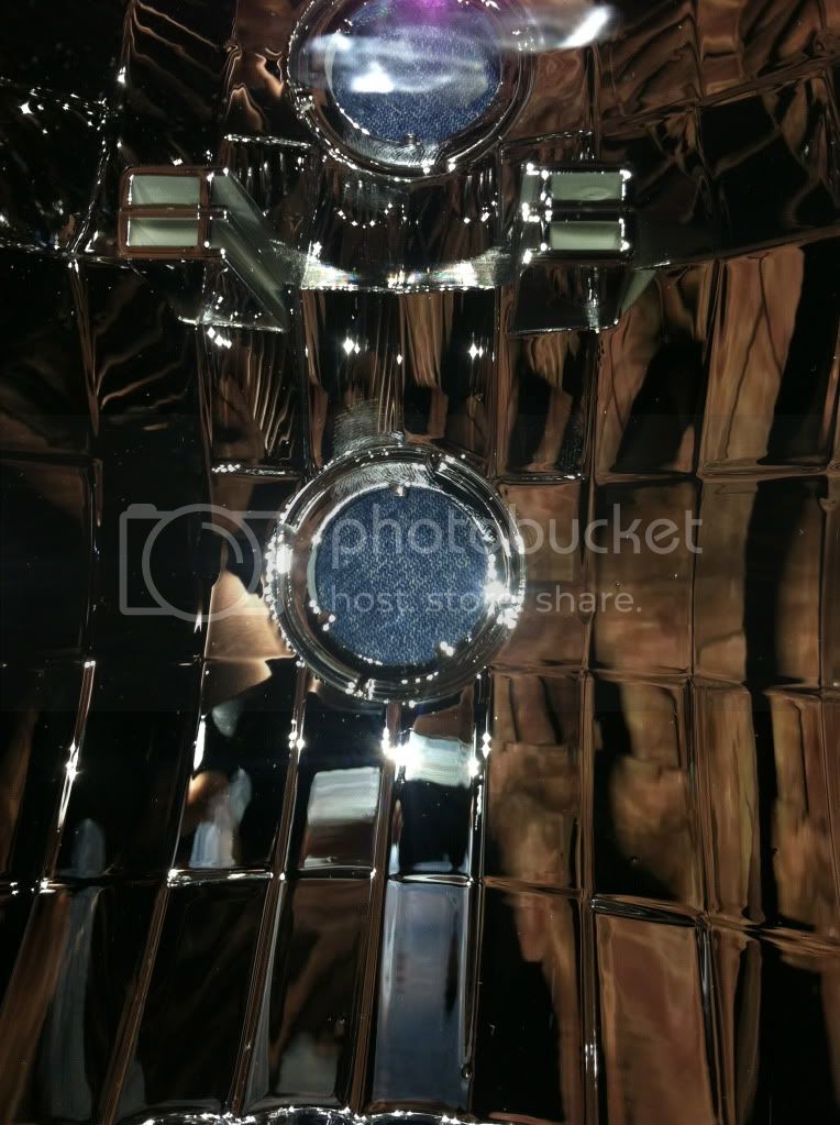

Now that the lenses are off, its time to put the retro fit projectors in.
First lets put the shrouds on the projectors, there are 4 screws to tighten them on. Not tough to do, but if forgotten to do, you gotta take the next steps apart to put back on.
Because these trucks come with a 9007 bulb stock, I got some of the 9007 adapters when I ordered the HID setup.
Without the Adapter
With the Adapter

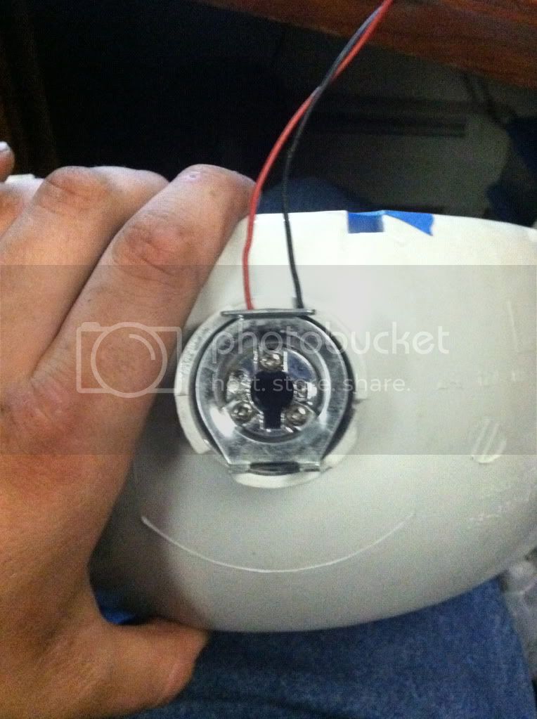

The flat spot with the two ears on the top is the guide for the Projector to slide though and be properly aimed. The two ears on either side are for the wires to go through that are used for the shield solenoid or the High Beams.

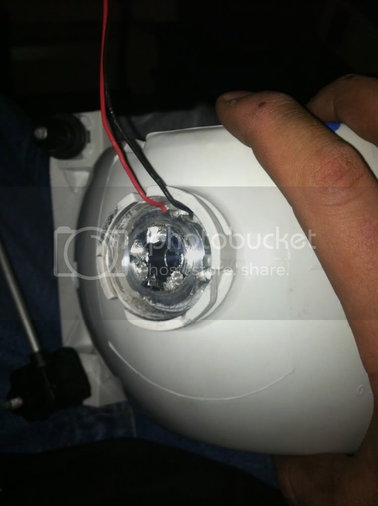

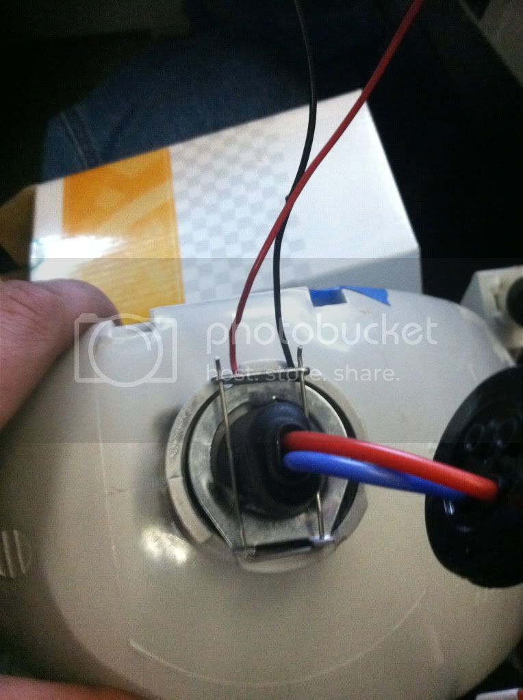

The kit comes with a few pieces. I used the big silicone white washer right on the projector, then the projector was fed through the housing while aligning the wires, and then I put the lock nut on them. The wires seem to get in the way a bit, but if you kinda push them down and out of the way of the lock nut its not terrible to tighten up. I just used a pair of needle nose.
Here is what it looks like with the lock nut on.
After those are tight, you can screw the bulb holder back onto the projector.
Then the bulb can slide in.
Here is what the other side looks like.
So now that everything here is done. Time to put the harness for the high lows on, which is not hard at all, the wires just slide in, but you have to make sure the black goes to the black. The harness other wires are Blue and Red. The Projector wires are Red. So the Red goes to the red or Blue, and the Blacks go to the Blacks.

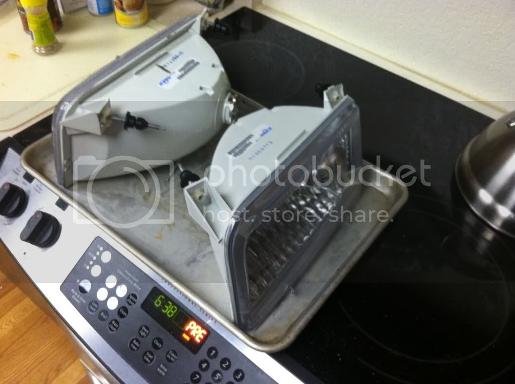

Final step is resealing the Housings. I bought the extra sealing glue to seal these back up. Take a strip of it and put it on the down the housing edges. Error on the out side of the housing (I did this on one, and the other I didn’t), otherwise you can see the glue on the inside.

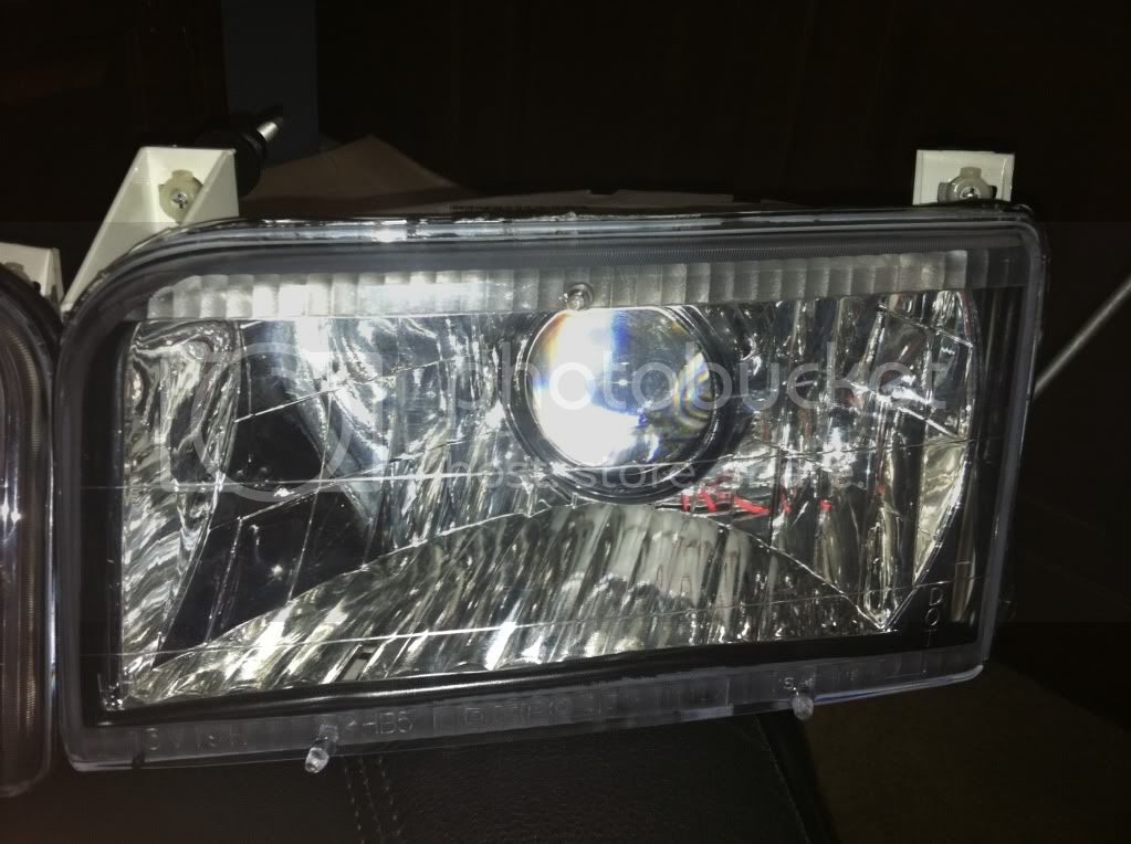

Once the stripe of glue is on both housings, put them in oven at 265 degrees for 8 minutes. Once you take them off, make sure that the lenses are clean and not printed up, as well as the reflective part in the housing. Then take the lenses and press them on. Make sure they are nice and tight. Wait for the glue to cool down and trim down the excess glue.
This is what they look like now. Ready to go in the truck.

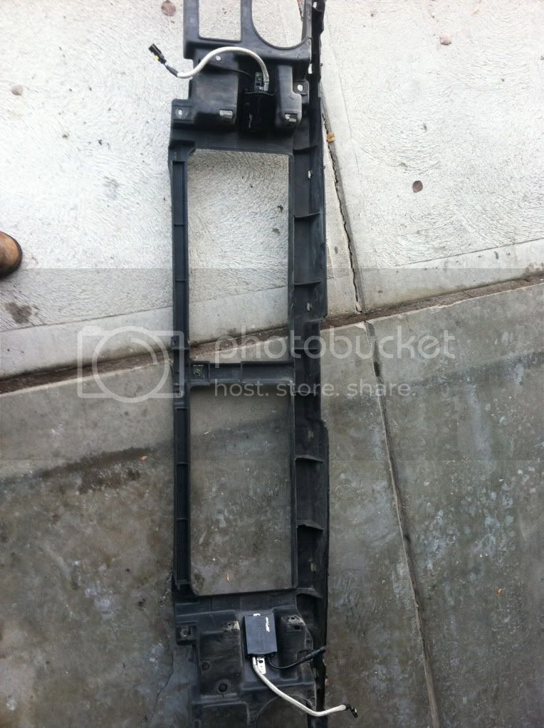

Once those are out, you can take the bulbs out and you are left with the two head lights on the truck and the header panel The header panel has 11 8 mm bolts holding it on. Take them out and then take the header panel off the truck with the headlights.

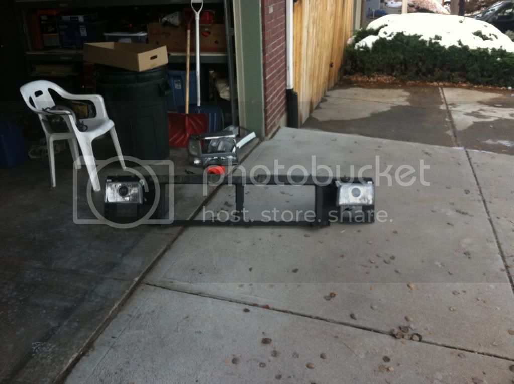

I then took the stock headlights and matched the new headlights screws and everything, so that they would be close in alignment. Then I installed them into the header panel.

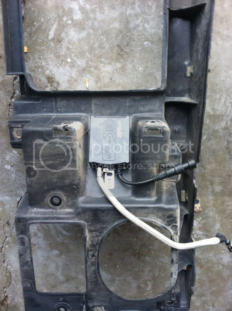

I had to find a place to mount the ballasts for the HIDs. I used the back of the header panel.

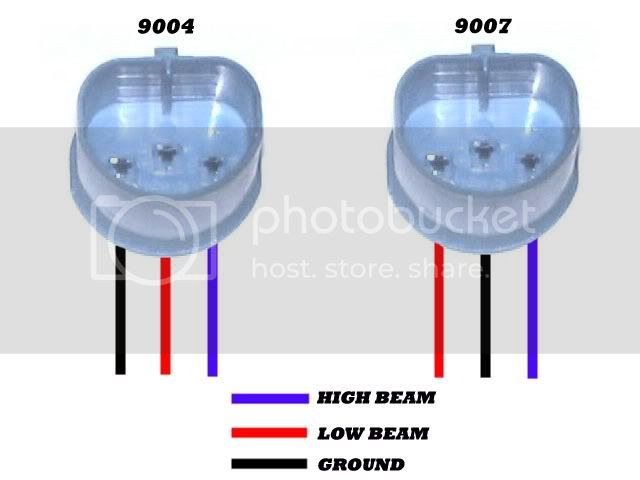

Thick black and red wires went to the ballasts. The Ballasts then were plugged into the bulbs. The high beam setup was blue and black. The projectors had the red and black. The red goes to the 12Vs (blue wire) and the ground goes to the blue.
Now the part that hooks to the input, is originally wired for a 9004 bulb. So the wiring there needs to change.
Simple swap. Now time to test and see if everything is working.

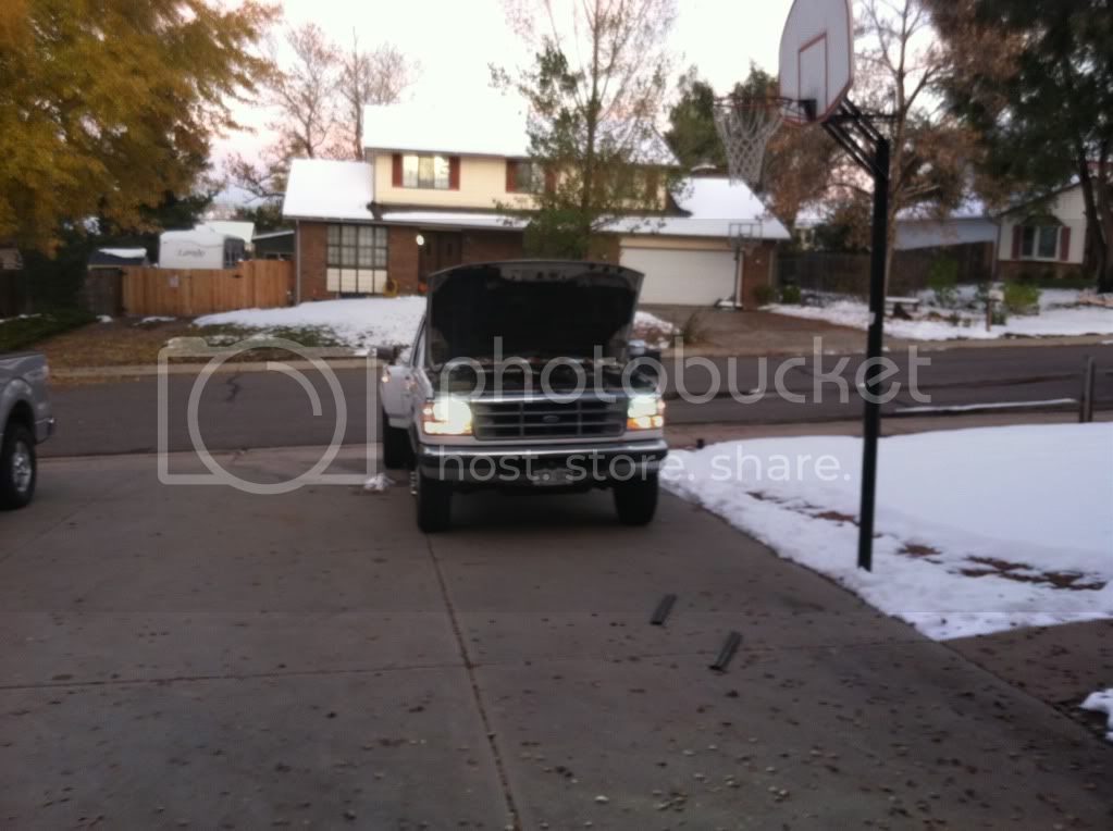

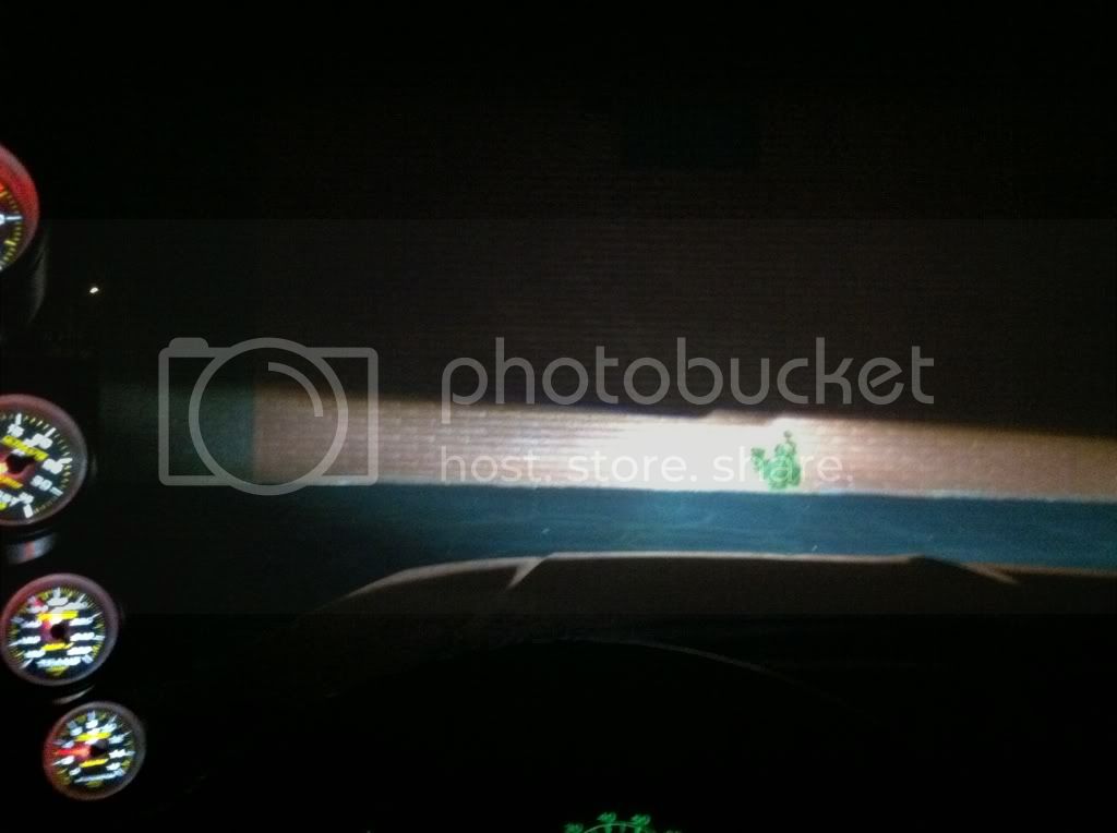

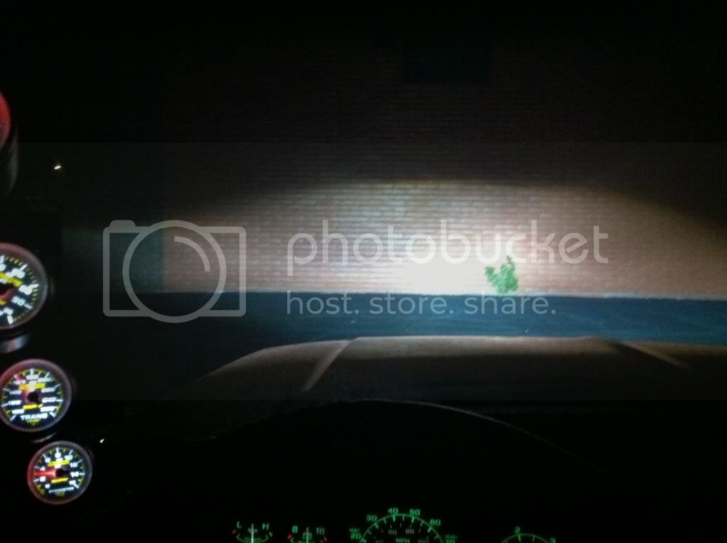

Now its time to reassemble. And do a final aiming of them. 25 feet out, the cutoff line from the projector should be 1-2 inches lower than the point they are on the truck.
Finished product!
Low beams parked parallel to the wall, makes a nice cutoff.
Low beams
Brights
Drove quite a bit last night, and I love these things! They are amazing.
