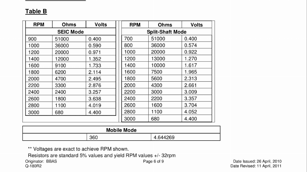

Sep 18, 2015 #5 T torque beast Member Joined Dec 22, 2013 Messages 375 Reaction score 1 Like jcain said I want to use a potentiometer so I can adjust the rpm just trying to find the resistance range needed
Sep 18, 2015 #6 T torque beast Member Joined Dec 22, 2013 Messages 375 Reaction score 1 Found this on a ford site in case someone else needs it

Sep 18, 2015 #8 T torque beast Member Joined Dec 22, 2013 Messages 375 Reaction score 1 No problem. Got another question though. All radio shack has is a 100k pot and I believe the pcm has limits to the rpms so this should work right?

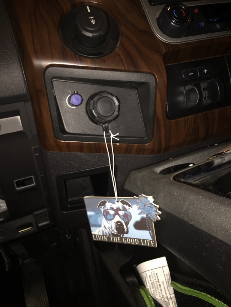

Sep 18, 2015 #9 T torque beast Member Joined Dec 22, 2013 Messages 375 Reaction score 1 And done. Works good
