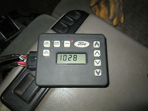

There is no high idle on a 94-97 truck. If you want one you need to either do a DIY high idle mod or get a chip with a high idle built into it.

Not on a 94-97. I have had mine down to a -40 with the brake set and still no high idle.
If you are handy doing electronics work I have a site that has instructions for a DIY AIC that you can make with parts from Radio Shack.

Have a Ford AIC. :)

I've had both my trucks idle up slightly in cold weather. It's not all that much, maybe 850 rpm or so (no where near 1100). I used a DIY AIC on the 94 which would go from idle up to over 2500 if I wanted. There was a TSB 94-19-18 for 94's only that was considered a customer-paid enhancement that allowed selectable RPM control using the brake pedal. Cheers!

Thats not really a high idle with what its doing, gotta be something to do with timing and what not when the oil is cold.
Even my SD when first started will idle around 700rpm then once the actual high idle kicks in to bring it to 1100.
But as stated the obs trucks didnt come from the factory with high idle unless you got the AIC box.

My truck has high idle I call it setting two! Other than the AIC a chip seems like the best way to get the high idle you're looking for.
